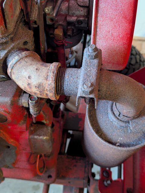

Phan 50 #1 Posted October 24, 2025 Hello - Can anyone please tell me if a muffler from B100 can be used for WH 12 Auto. Any specific instructions for removing / installing the muffler - should I use a liquid lubricant / sealing. Share this post Link to post Share on other sites
Lee1977 7,551 #2 Posted October 24, 2025 Can't say for sure as I have never had a B-100, but it should fit, Kohler standard sized the engines in 1959. 1 Share this post Link to post Share on other sites
oliver2-44 11,212 #3 Posted October 25, 2025 Penetrant can help with removal. No liquid sealant need for installation. 1 Share this post Link to post Share on other sites
Retired Wrencher 6,448 #4 Posted October 25, 2025 Plan may be some picks would help? We like picks! 1 Share this post Link to post Share on other sites
Phan 50 #5 Posted October 25, 2025 I have attached pictures - the one from B100 will be replaced on WH 12 Auto. Share this post Link to post Share on other sites
Retired Wrencher 6,448 #6 Posted October 26, 2025 Thanks for the picks @Phan. Did you make the one in the second picture. Just curious. Why so many angles. Share this post Link to post Share on other sites
Phan 50 #7 Posted October 26, 2025 3 hours ago, Retired Wrencher said: Thanks for the picks @Phan. Did you make the one in the second picture. Just curious. Why so many angles. Someone did before me Share this post Link to post Share on other sites
Phan 50 #8 Posted October 26, 2025 I am unsure if the muffle from the B100 can fit to Auto 12?... 1 Share this post Link to post Share on other sites
rmaynard 16,864 #9 Posted October 28, 2025 The B-100 and the 12 Automatic are very similar. The 12 HP and the 10 HP engines are the same dimensions. Just measure the distance from the front of the oil pan to the inside of the bottom of the hood. It should be 6-1/2" +/-. If so, it should work. Share this post Link to post Share on other sites
