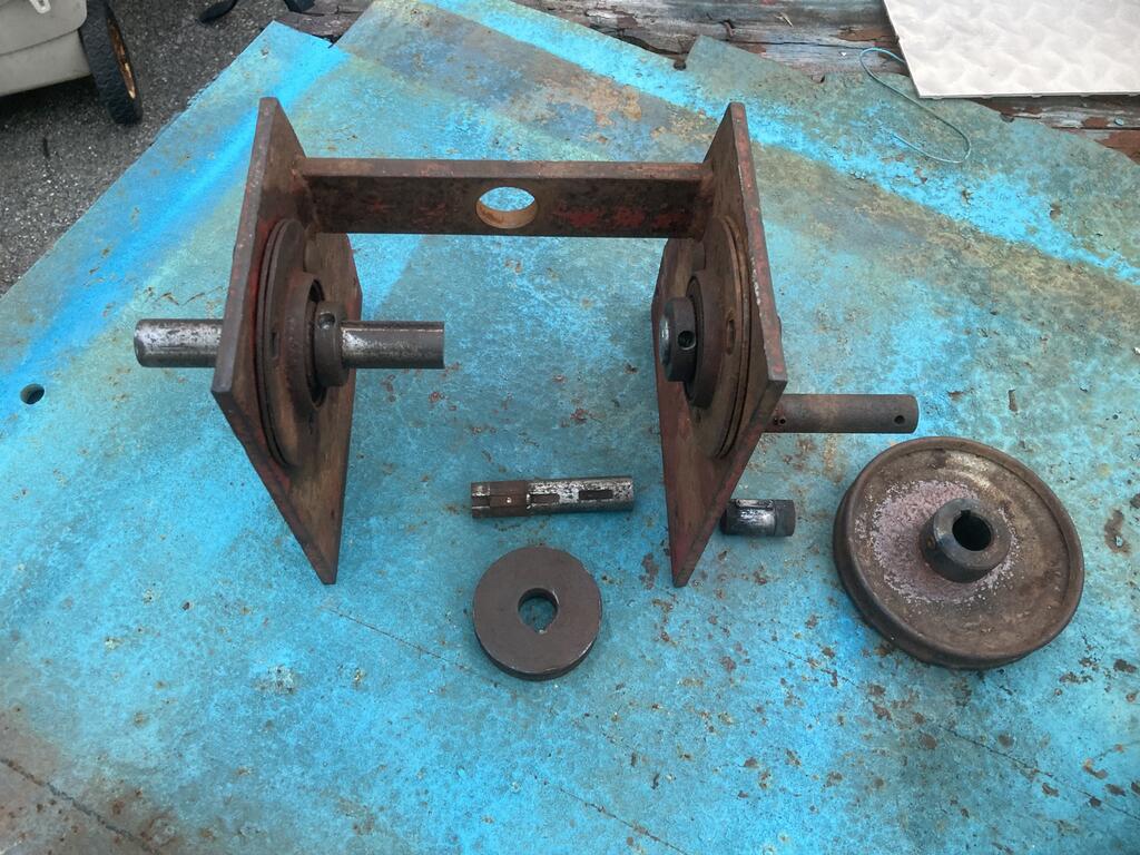

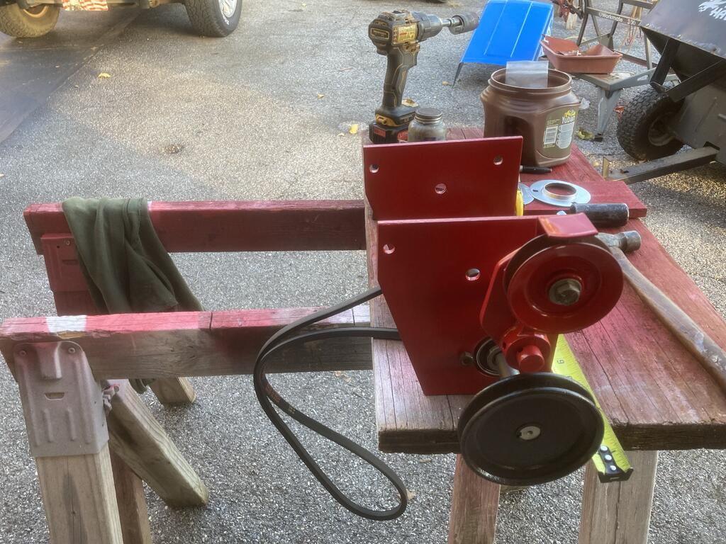

"Manic-Mechanic" 1,425 #1 Posted October 23, 2025 (edited) This ass’y is apart with some quick cuts and a press! Salvaged the pulleys! Get it cleaned up and paint refreshed, new parts in route Edited October 23, 2025 by "Manic-Mechanic" 3 Share this post Link to post Share on other sites

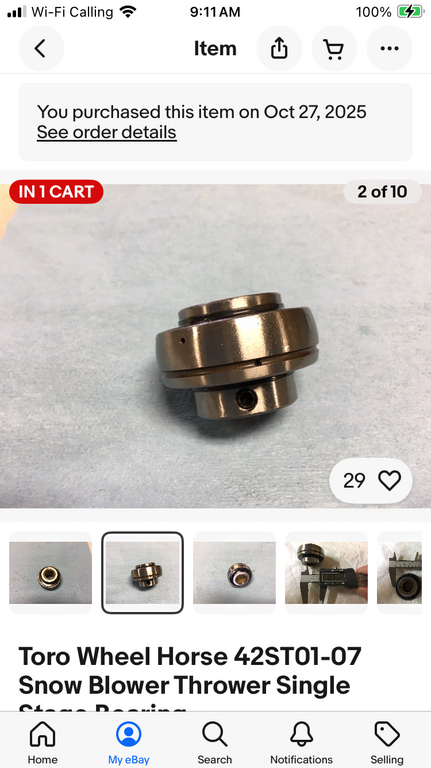

"Manic-Mechanic" 1,425 #2 Posted October 24, 2025 (edited) I have 3/4x52mm insert bearing, Edited October 27, 2025 by "Manic-Mechanic" 1 Share this post Link to post Share on other sites

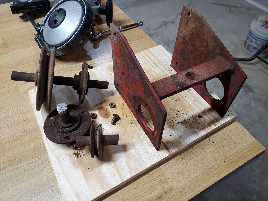

Racinbob 12,503 #3 Posted October 24, 2025 That brings back memories. I found replacements and a new shaft at Surplus Center. 1 Share this post Link to post Share on other sites
"Manic-Mechanic" 1,425 #4 Posted October 24, 2025 6 hours ago, Racinbob said: That brings back memories. I found replacements and a new shaft at Surplus Center. Yeah, it was almost against my religion to do it this way but having three different resting points simultaneously to press the components was a task beyond my comprehension! Share this post Link to post Share on other sites
Racinbob 12,503 #5 Posted October 24, 2025 10 minutes ago, "Manic-Mechanic" said: Yeah, it was almost against my religion to do it this way but having three different resting points simultaneously to press the components was a task beyond my comprehension! I know exactly what you mean. I invented some new words but that didn't help. Getting the yoke freed up was another story but I had to win that one. 1 1 Share this post Link to post Share on other sites
"Manic-Mechanic" 1,425 #6 Posted October 24, 2025 4 minutes ago, Racinbob said: I know exactly what you mean. I invented some new words but that didn't help. Getting the yoke freed up was another story but I had to win that one. The first one, a 42”, the yoke was in pieces! I found a machine shop “willing” to repair it after several declinations, and that was a true test of faith! Share this post Link to post Share on other sites

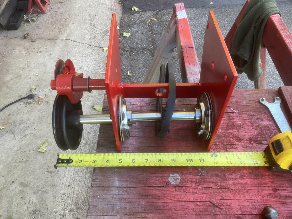

"Manic-Mechanic" 1,425 #7 Posted November 2, 2025 I have it all together for test fit, the 3/4” shaft is barely the length I’d like it to be. Debating whether or not to use remote grease stations over having to try an access them directly 1 Share this post Link to post Share on other sites
