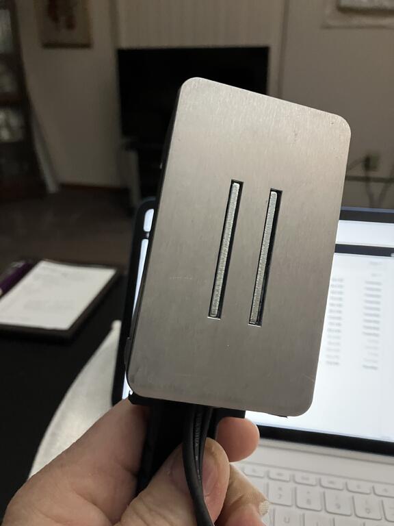

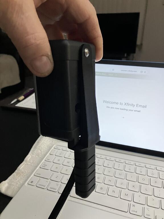

I pick this up on EBay for about $30. I using it on the 64 engine I have because it has no A-C-R. Should help for cold start ups. Also I hate changing oil for winter the to summer use. It has a magnetic base. Should fit or work between the frame rails. It heats up right away goes to 200° should work nicely heating up the oil.

Have one similar and it was a failure. The metal bars in the center are the magnets and on mine they are loose. I suspect they can stick to uneven surfaces since they are independent of each other. Problem is the surrounding hot area of the heater does not make engine contact so no heat transfer. The heater is hanging on the magnets. I added a 12" strip of wood to the back of the heater with an eye on each end. Now a bungee cord over the engine keeps the hot area up tight to the oil pan and works.
Just something to watch out for.

Sorry to hear that Garry. I have a deep oil pan so it fits right on the pan itself by the PTO. So time will tell if this actually works for 30 dollars it was worth a shot. Thanks for the post.

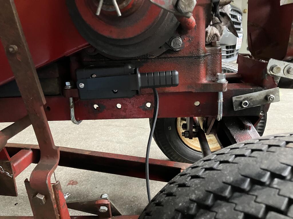

This is where mine fits.

Mike I posted where mine is mounted. I am glade yours is working fine. I just hope this works for three mounts of the year,
