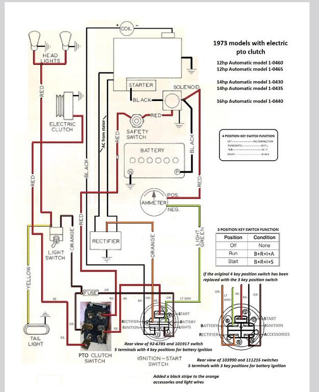

pfrederi
There was a safety switch set up to prevent you from starting tractor with PTO engaged.  Sounds like someone tried to by pass it and messed things up.  This shows how it should be wired.
  For your lift issue make sure the spring 7-33 is on place and the block 7-37 move freely

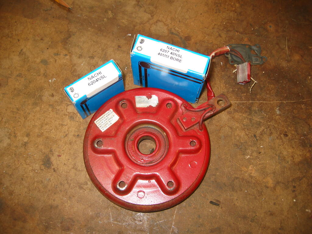

pfrederi
You are missing the field coil for your electric PTO...may want to look at converting to a manual PTO
  • Like 1
Phan
I do not know parts in the two boxes. I also think to convert to manual too. The tractor runs very strong, I got for 300 CAD - an unual price selling in Canada.
Phan
The boxes are bearings - Thank you !
