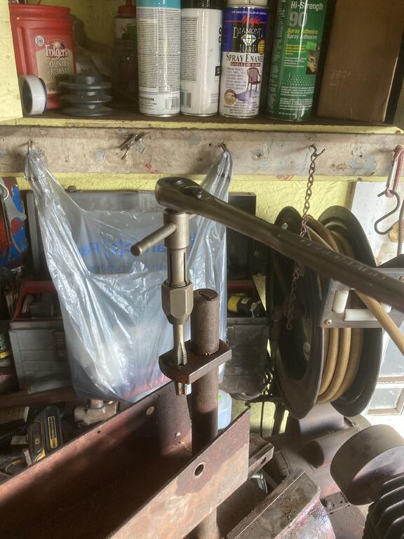

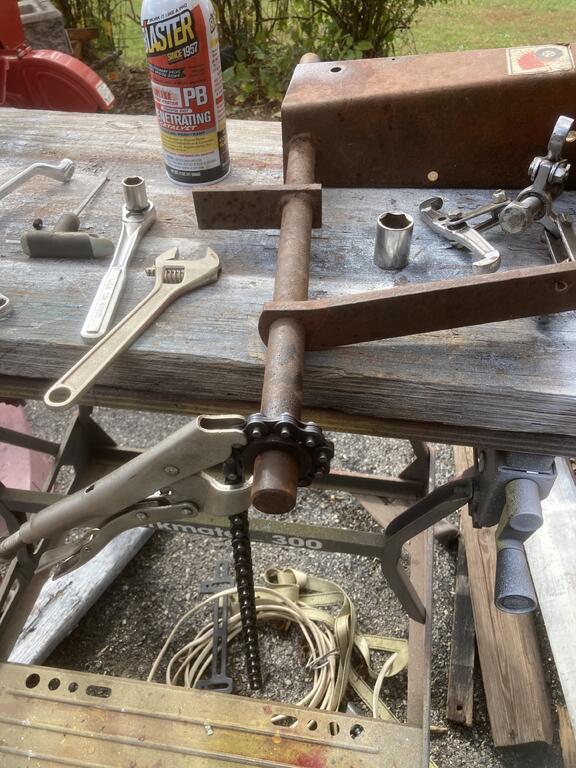

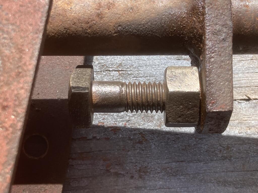

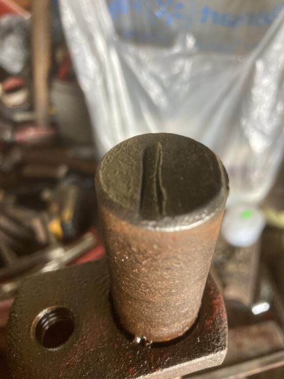

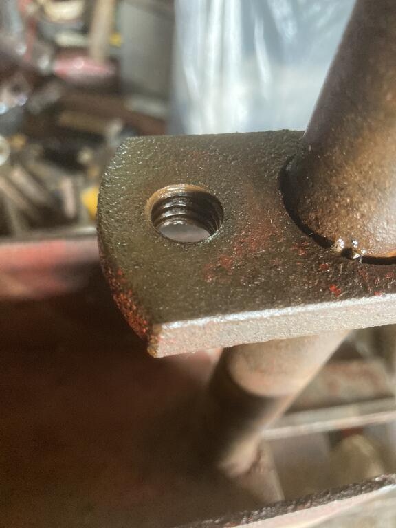

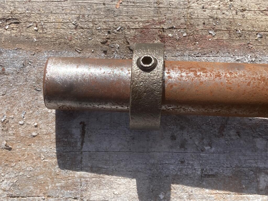

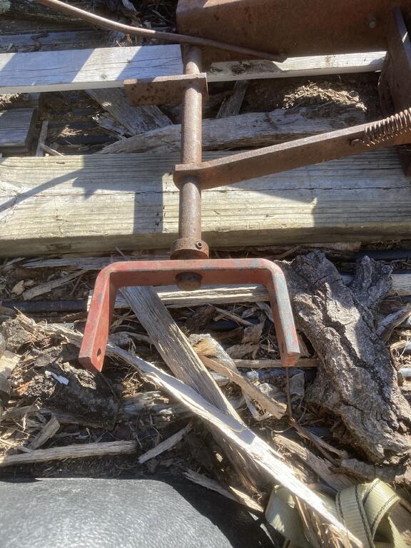

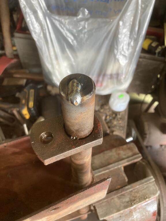

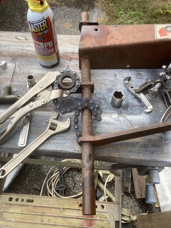

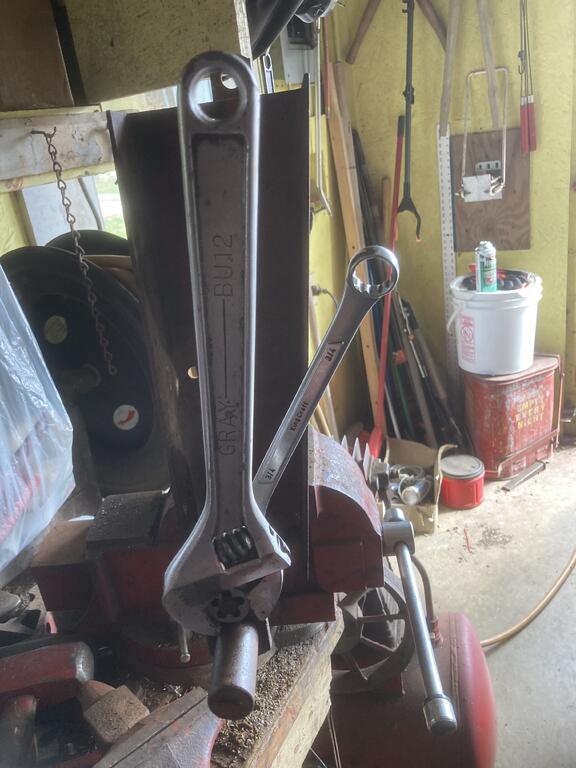

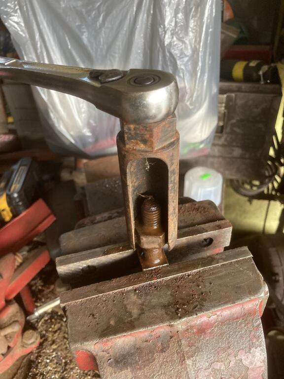

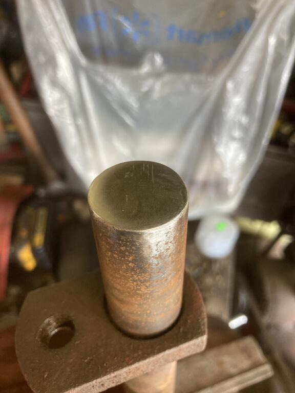

"Manic-Mechanic" 1,485 #1 Posted October 21, 2025 (edited) I believe this to be a part of SMS-50 I see this bracket has limited back & forth motion, different than my last rebuild… Removing the collar Love it when it slides off! Running die over the protruding thread, helps on the way out. Clean up that thread Shiny! Pulley gash! Nice little bead Nice and presentable Open socket to apply lube while cleaning threads Shaft & collar functional again Tension bolt & nut functioning again Edited October 21, 2025 by "Manic-Mechanic" 4 1 Share this post Link to post Share on other sites
