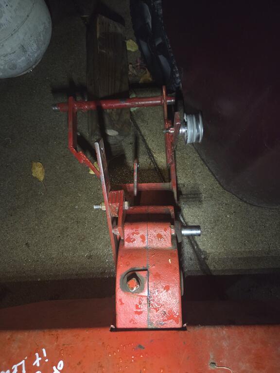

markseven 93 #1 Posted October 21, 2025 Had to do a little fab work to get this to fit my bronco 14. When I bought the tiller I didn't realize it wasn't the rite tiller. Probably was made for a newer series? 2 Share this post Link to post Share on other sites

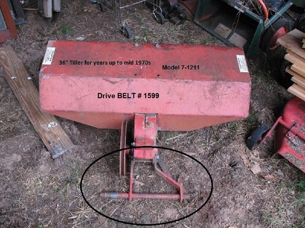

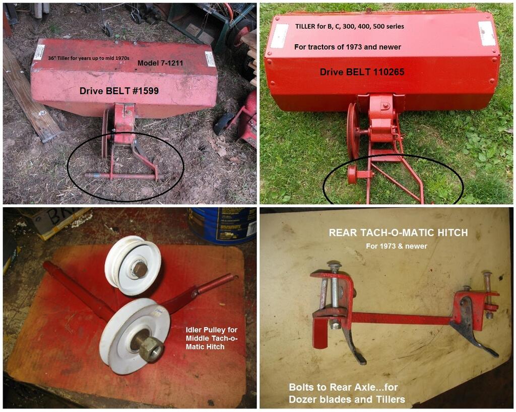

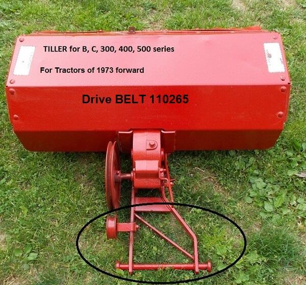

ebinmaine 77,974 #2 Posted October 21, 2025 What did you have to do for Fab work? I'm wondering if you could have purchased later style brackets? 2 Share this post Link to post Share on other sites
daveoman1966 3,882 #3 Posted October 21, 2025 Tiller hookups ---- two types. 1973 was the change-up year. 1 2 Share this post Link to post Share on other sites
