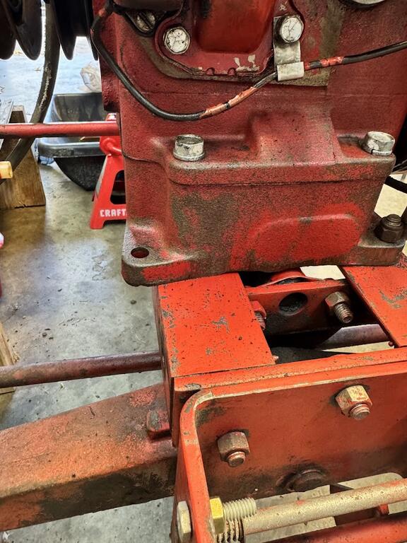

Bar Nuthin 2,181 #1 Posted October 21, 2025 (edited) I was addressing an oil leak around the breather and adjusting the valves on Frankenhorse, today. I looked down and noticed the right side of the engine hangs over the outside of the frame. Note; It's a '73 16-Auto with a newer K321S engine. I'm not experienced with the different variations on K Series engines, so what gives here? And what are recommendations on the best resolution. Edited October 21, 2025 by Bar Nuthin Share this post Link to post Share on other sites
oliver2-44 11,212 #2 Posted October 21, 2025 There's nothing wrong with it hanging over, that the factory design. Look under the frame angle on that side and you will see 2 bolts that go up into the bottom of the oil pan. 1 3 Share this post Link to post Share on other sites
sqrlgtr 2,165 #3 Posted October 21, 2025 look up under frame and you will see the motor bolts that hold engine on that side perfectly normal. I dont know what all Wheel Horse tractors are this way but this series is for sure. 1 Share this post Link to post Share on other sites
sqrlgtr 2,165 #4 Posted October 21, 2025 oily beat me to it 3 Share this post Link to post Share on other sites
Bar Nuthin 2,181 #5 Posted October 21, 2025 (edited) 40 minutes ago, oliver2-44 said: There's nothing wrong with it hanging over, that the factory design. Look under the frame angle on that side and you will see 2 bolts that go up into the bottom of the oil pan. Thanks! I have enough issues to address on this thing already! Never noticed it on my C-120 - but yep - same. Edited October 21, 2025 by Bar Nuthin 3 Share this post Link to post Share on other sites

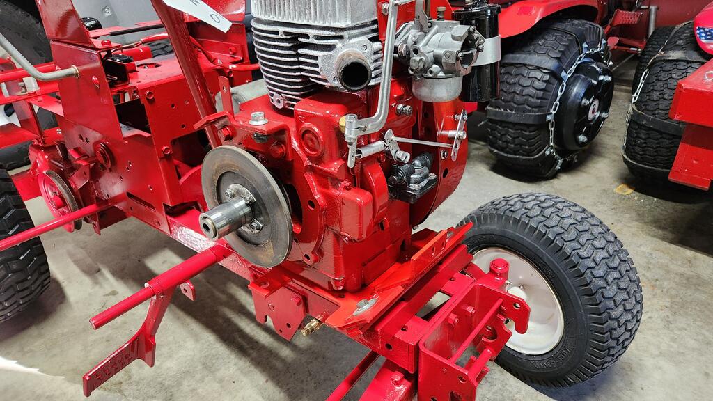

Bar Nuthin 2,181 #7 Posted October 21, 2025 10 minutes ago, MainelyWheelhorse said: @Bar Nuthin My C-141, 312-8 and 308-8 are all like that too. My recently acquired C-141 is mounted on a plate with rubber dampeners. Share this post Link to post Share on other sites
oliver2-44 11,212 #8 Posted October 21, 2025 1 hour ago, Bar Nuthin said: My recently acquired C-141 is mounted on a plate with rubber dampeners. Yes, the engine mounting design changed on the C1x1 models to the rubber shaker plate design. 2 Share this post Link to post Share on other sites
MainelyWheelhorse 2,327 #9 Posted October 21, 2025 1 hour ago, Bar Nuthin said: My recently acquired C-141 is mounted on a plate with rubber dampeners. Ok, that must be factory. The C-141 started off with that and the C-85 has it too. I took it off the C to simplify the engine mounting, especially if there was a problem during the motor install. I’m used to the 3/4/500 series and I didn’t notice any major vibration issues with it off so I left it. The later tractors don’t have that mount. It’s probably a cost cutting reason but there doesn’t seem to be major vibration on those either. 2 Share this post Link to post Share on other sites
Bar Nuthin 2,181 #10 Posted October 21, 2025 42 minutes ago, MainelyWheelhorse said: there doesn’t seem to be major vibration on those either To be honest, the only difference I notice is the engine shaking around. In fact, it shook the muffler loose the other day - not that it was tight to begin with. 2 Share this post Link to post Share on other sites
ebinmaine 77,324 #11 Posted October 21, 2025 5 hours ago, MainelyWheelhorse said: Ok, that must be factory. The C-141 started off with that and the C-85 has it too. I took it off the C to simplify the engine mounting, especially if there was a problem during the motor install. I’m used to the 3/4/500 series and I didn’t notice any major vibration issues with it off so I left it. The later tractors don’t have that mount. It’s probably a cost cutting reason but there doesn’t seem to be major vibration on those either. 4 hours ago, Bar Nuthin said: To be honest, the only difference I notice is the engine shaking around. In fact, it shook the muffler loose the other day - not that it was tight to begin with. Those rubber mounts are WELL known to dry rot and disintegrate. Go to a solid metal type. 5 Share this post Link to post Share on other sites
ri702bill 11,254 #12 Posted October 21, 2025 49 minutes ago, ebinmaine said: Those rubber mounts are WELL known to dry rot and disintegrate. Go to a solid metal type. I added the solid mounts on my C81, as the entine engine / shaker plate would torque twist to the rear when I engaged the PTO. No movement at all now. 3 2 Share this post Link to post Share on other sites
Racinbob 12,765 #13 Posted October 21, 2025 If a wobble mount it removed the engine needs to be mounted so the shaft is at the same height. Another consideration is the lower bracket for the PTO loop. It's part of the wobble mount. Maybe the easiest way is to install the solid mounts in place of the rubbers like Bill did. I modified the base on Dino. If you choose to eliminate the entire mount and plan on using the PTO you'll need to come up with a way to support the bottom of the loop. There are several good ideas the guys have posted. If you're thinking just swap the oil pan, forget it. I don't think cost had much to do with the addition of the mount. Obviously it cost more. But the fact that it didn't last long before they went back to a direct bolt pretty much tells you that it was a bad idea. I've had a couple and they only made the engine shake worse. 3 Share this post Link to post Share on other sites

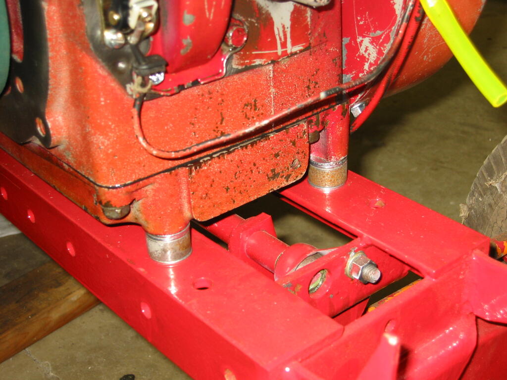

953 nut 64,108 #14 Posted October 21, 2025 10 hours ago, Bar Nuthin said: 10 hours ago, oliver2-44 said: There's nothing wrong with it hanging over, that the factory design. Look under the frame angle on that side and you will see 2 bolts that go up into the bottom of the oil pan. Thanks! I have enough issues to address on this thing already! Never noticed it on my C-120 - but yep - same. Here is a picture of the oil sump from the bottom. If a person were to buy a non-Wheel Horse engine without the holes for frame mounting a pair of "J" Bolts would do the trick. 4 Share this post Link to post Share on other sites
JoeM 9,618 #15 Posted October 21, 2025 1 minute ago, 953 nut said: frame mounting a pair of "J" Bolts would do the trick I had one with the hooks. It had a replacement k (one of the dark green ones). it worked fine. 5 Share this post Link to post Share on other sites

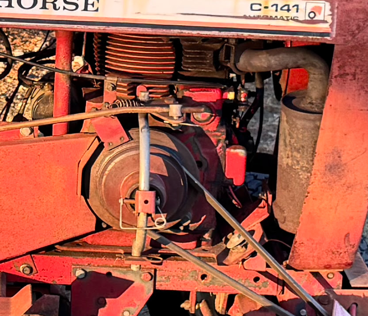

peter lena 9,763 #16 Posted October 21, 2025 @Bar Nuthin side engine picture , opportunity to enhance / quiet down the sloppy PTO LEVER SET UP ? hitch pin clip at bottom of pto swing arm , see the hole at end of upper corner clip ? add a medium extension spring , connect the 2 clips n no more noise , rattling . also a great time to remove the rattling upper TRUNION on pto lever end adjustment area , thats a 3/8x 16 thread , get a 3/8x24 DIE NUT , rethread right over those threads screw on a HEIM JOINT , , also like to pull off the , pto cone , clean out the inner needle bearing , like lucas green chassis grease , very light ammount ? excess flings to clutch face . very smooth / easy improvement , you can also washer up the start of the PTO LEVER ROD , coming from battery tray area , makes for solid smooth engagement , gold mine for simple improvements , pete 1 Share this post Link to post Share on other sites

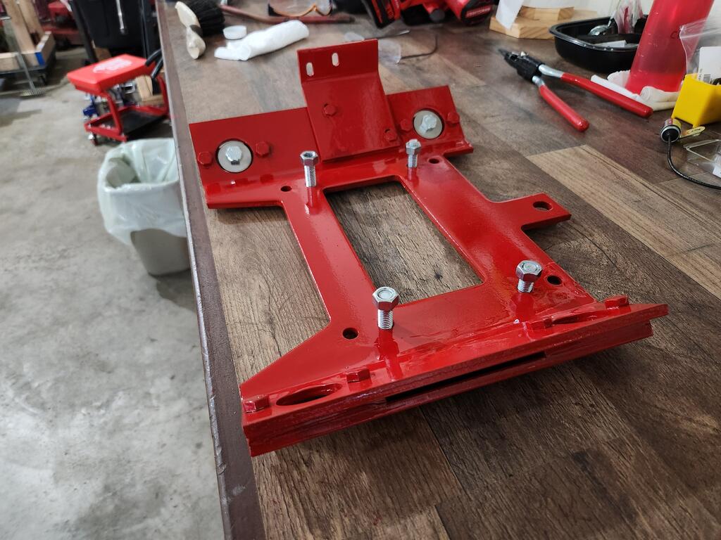

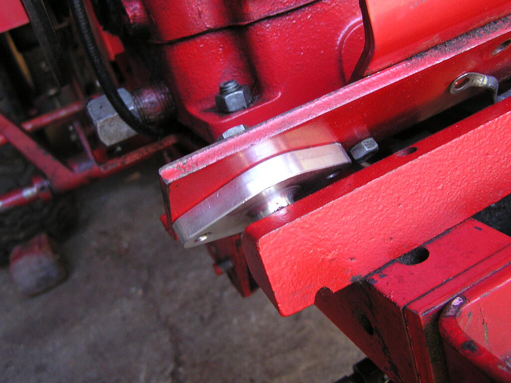

Bar Nuthin 2,181 #21 Posted January 21 FB find arrived today. $40 seemed reasonable enough. 1 Share this post Link to post Share on other sites

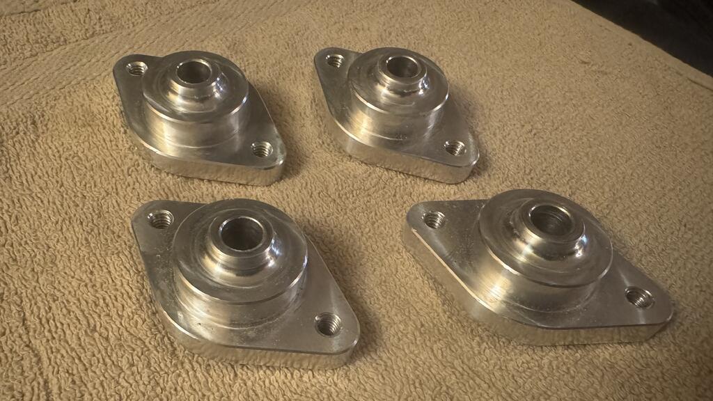

mrc 1,052 #22 Posted January 22 last time i checked toro was getting about $125. for the replacement rubber mounts for a set of four. those shiny aluminum mounts are made by zach kerber and the last time i checked they were about $60. for a set of four. 1 Share this post Link to post Share on other sites
