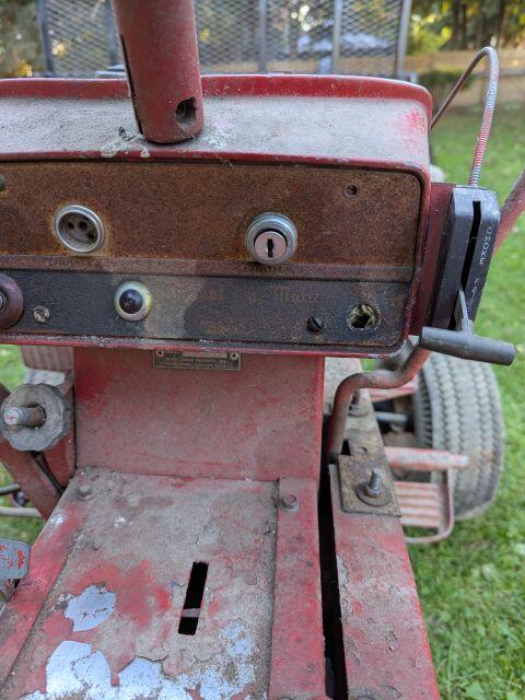

Phan 68 #1 Posted October 16, 2025 Hello - I picked up 1075 recentlly with no key. I have tried with all keys that used for 865 and C, B, and 300 series, but it cannot ne inserted. Looking at the manual - it said the swich 4988. Anyone knows and where I can get the key. Thanks Share this post Link to post Share on other sites

Phan 68 #5 Posted October 17, 2025 Hello All! Thank you! The switch has been replaced. I found it in the amazon is matching the switch on the tractor. I ordered it and will arrive tomorrow. https://www.amazon.ca/dp/B093PDJRSF? ref=ppx_yo2ov_dt_b_fed_asin_title But the engine cease - cannot turn by hand. Share this post Link to post Share on other sites
953 nut 68,140 #6 Posted October 17, 2025 The switch you have purchased is intended to operate with a solenoid. It is only rated at 30 amps and your starter will draw about 50 amps. Do you have a solenoid? 1 Share this post Link to post Share on other sites
Retired Wrencher 6,902 #7 Posted October 17, 2025 Richard is correct. If you want to bring it back to original I just pick up an original type key from wheel horse parts and more.com. This is this switch works with the start GEN tractors. I hope everything works out. Just take your time. 1 Share this post Link to post Share on other sites
Phan 68 #8 Posted October 17, 2025 4 hours ago, 953 nut said: The switch you have purchased is intended to operate with a solenoid. It is only rated at 30 amps and your starter will draw about 50 amps. Do you have a solenoid? No selenoid. Share this post Link to post Share on other sites
Phan 68 #9 Posted October 17, 2025 4 hours ago, Retired Wrencher said: Richard is correct. If you want to bring it back to original I just pick up an original type key from wheel horse parts and more.com. This is this switch works with the start GEN tractors. I hope everything works out. Just take your time. I will consider it. I hope I can crang the engine - it seiges now. Share this post Link to post Share on other sites
