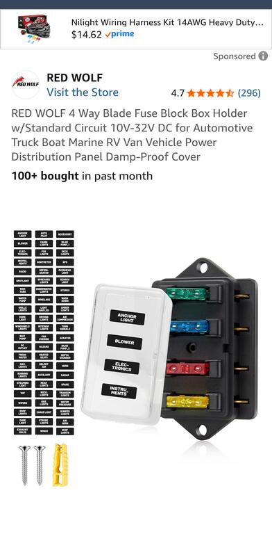

Lee1977 7,443 #12 Posted October 16 Those open fuse holder can be the problem. Had a good battery and fuse and and nothing coming out the other side of the holder. 1 Share this post Link to post Share on other sites
Joefrommi65 26 #13 Posted October 16 Thanks lee Funny enough I was just looking at that I think I will order a small one for a boat from Amazon .It looks like the previous owner had the same issue and put in line fuses and only left 1 fuse in it Share this post Link to post Share on other sites
