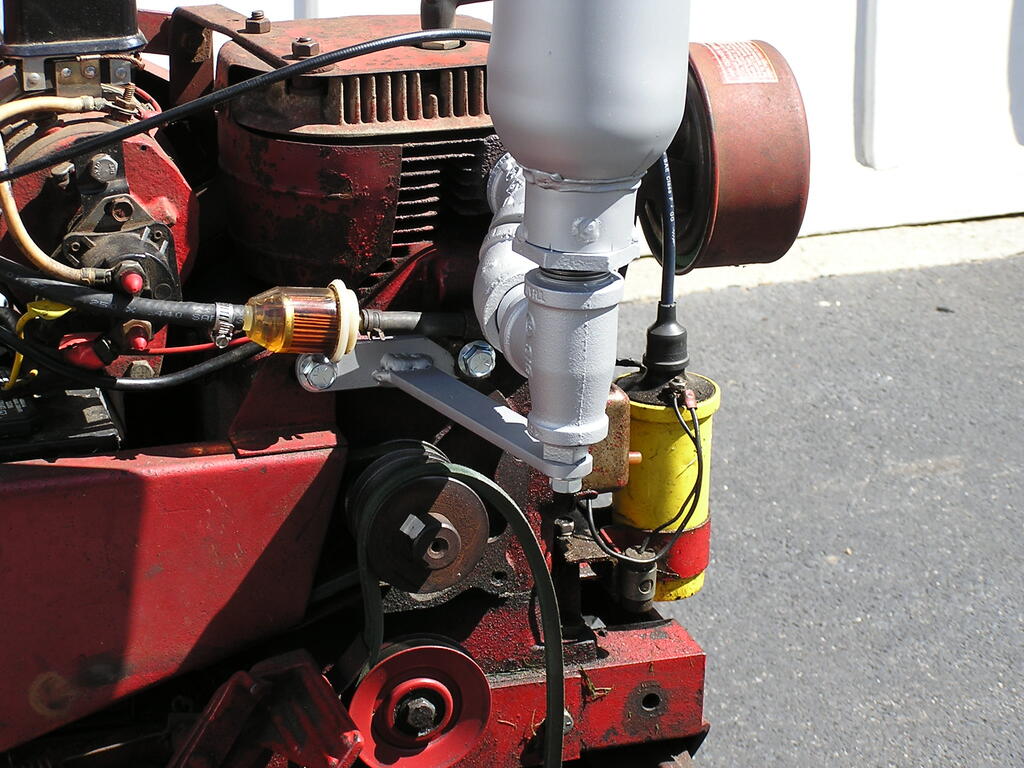

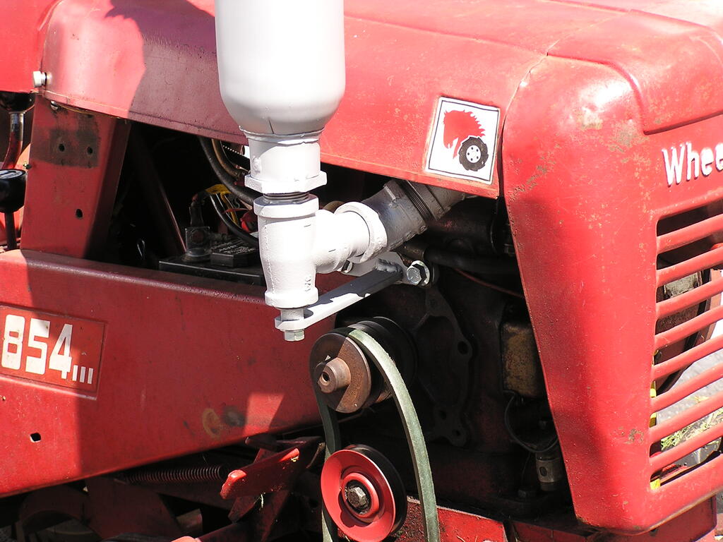

ri702bill 10,958 #5 Posted October 10, 2025 Consider adding a lower support, this is mine on the 854... 3 Share this post Link to post Share on other sites
