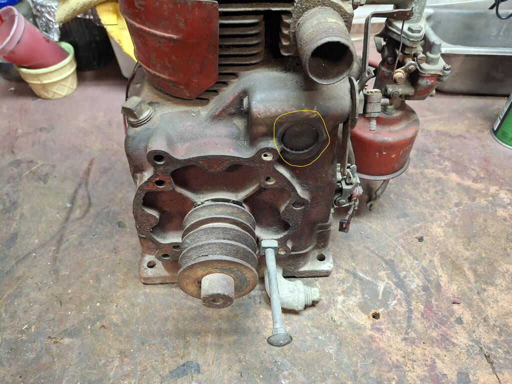

wheelhorsejoe 4 #1 Posted October 8, 2025 Hi, I was wondering if anyone knows were I can get a camshaft plug for a 341 k series? Thanks Share this post Link to post Share on other sites

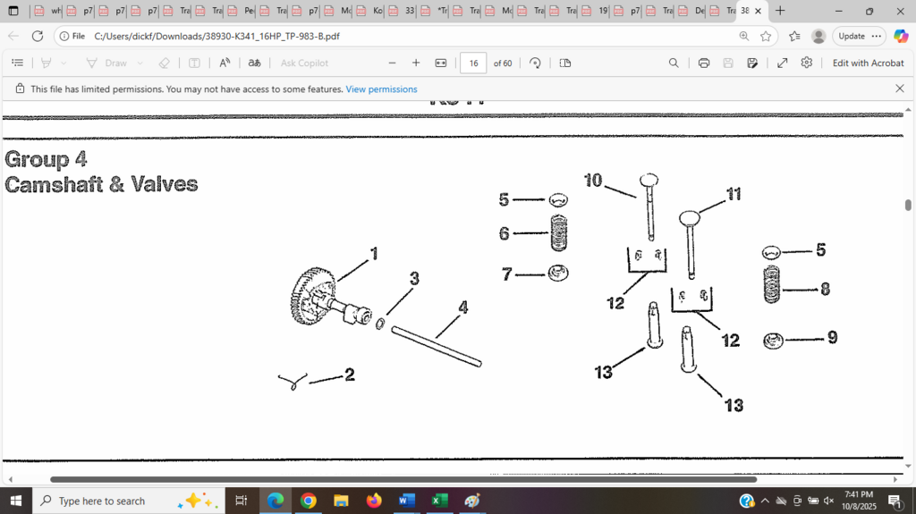

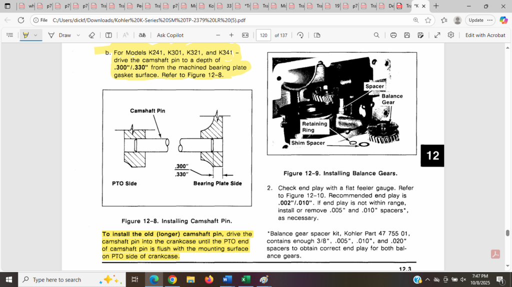

953 nut 63,547 #2 Posted October 8, 2025 Was there a plug when you took it apart? I am not aware of one and the parts manual and service manual do not show a plug. Share this post Link to post Share on other sites
squonk 45,059 #3 Posted October 9, 2025 Different engine but I think he means this. 2 Share this post Link to post Share on other sites
johnnymag3 2,634 #4 Posted October 10, 2025 (edited) McMaster Carr has any size plug you want, with more info and specs. than you'll ever need Edited October 10, 2025 by johnnymag3 1 Share this post Link to post Share on other sites
