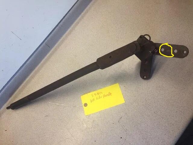

Phan 53 #1 Posted October 4, 2025 Hello, I hope everyone has been enjoying the minutes of summer! Me too! I am wondering if a 36-inch snow blower can be attached to a B80. I recently sold them to someone (per his requested), and am regretful if it cannot do the work for him. The PTO handle does not seem to hold (no click). How can I adjust it and looks like no even. Thank you! Pxl 20250921 191837936(1).mp4 Share this post Link to post Share on other sites
rjg854 12,915 #2 Posted October 4, 2025 The spring inside is most likely broken, or could be a rust situation. 2 Share this post Link to post Share on other sites
Phan 53 #3 Posted October 4, 2025 And how to fix it - if the spring break, can we replace it? Share this post Link to post Share on other sites

squonk 45,892 #5 Posted October 4, 2025 (edited) What hole do you have the lift flag in on the lifting arm? The flag pin should be in this hole. If you put it in the other hole it will be hard to lift and the lift tube will hit the front axle before the lift handle locks. Edited October 4, 2025 by squonk 1 1 Share this post Link to post Share on other sites
