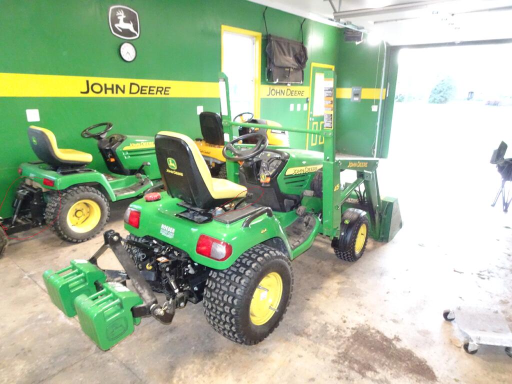

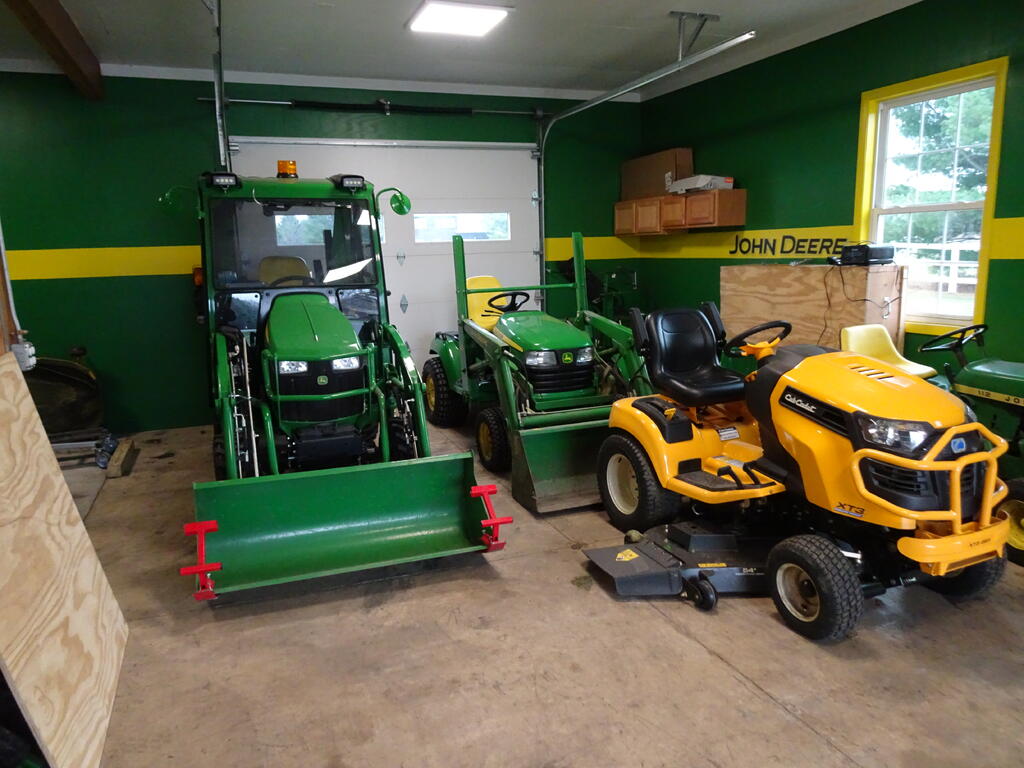

sergeant 350 #12 Posted October 5, 2025 10 hours ago, rjg854 said: Do you have a thing for JD I actually have a thing for all garden tractors, regardless of manufacturer. My Current collection Cub Cadet Original Garden Tractor Cub Cadet 60 Rear engine rider Cub Cadet 70 Garden Tractor Cub Cadet 106 Garden Tractor Cub Cadet 1450 Garden Tractor Cub Cadet 2182 Garden Tractor Cub Cadet 3208 Garden Tractor Cub Cadet XT3 GSX Garden Tractor Cub Cadet Z-Force SX54 Zero turn Ingersoll 3016PS Garden Tractor John Deere 110RF Garden Tractor John Deere 112SF Garden Tractor John Deere 140H3 Garden Tractor John Deere GX335 Garden Tractor John Deere X748 Garden Tractor John Deere Sabre 1542 HS Lawn Tractor Simplicity Wonder-Boy Rear Engine Rider Wheel Horse 416H Garden Tractor White GT2055 Garden Tractor John Deere 2025R TLB Compact Tractor The Deere-painted label on the walls matched my former 1025R hood label. The barn addition is white on the inside but has 5 doors, each painted a different tractor color. Deere Green and Yellow, Wheel Horse Red, Cub Cadet Yellow, Allis Orange (non-working doorway), and Ford Blue (non-working doorway) 3 1 Share this post Link to post Share on other sites

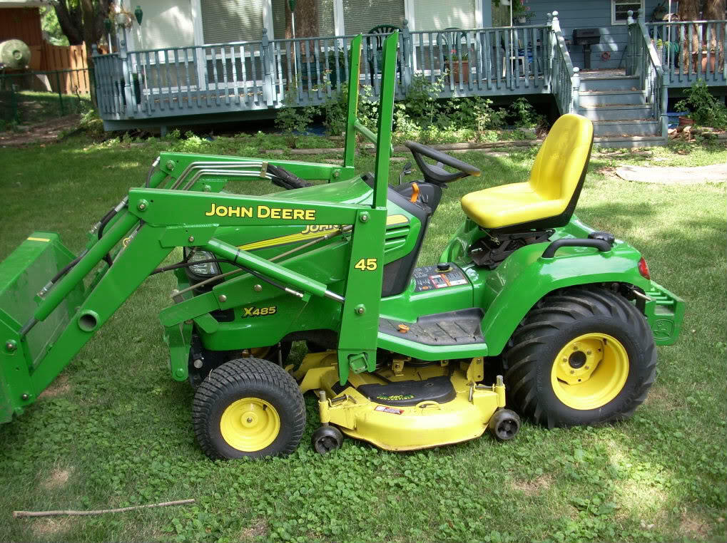

sergeant 350 #16 Posted October 11, 2025 (edited) 4 hours ago, Handy Don said: Well said. On the Hudson Valley CL, search for "2012 John Deer 2305 MFWD Compact Tractor w Loader & Mower Deck” to see an example of big enough to do both interchangeably without a lot of fuss. And the cost--quite a bit more than two (or even five?!) nice WHs. Again, no need for a subcompact. The following Deere garden tractor models allow the loader and mowing deck to be on at the same time if needed. even the Older 1980's Deere 300 & 400 series even with the seperate Pump Loaders allowed the Mowing deck to be Mounted at the same time as the 44 Loader if Needed 425 OEM 40 Loader or aftermarket CTC Loader 445 OEM 40 Loader or aftermarket CTC Loader 455 OEM 40 Loader or aftermarket CTC Loader X475 OEM 45 Loader or Aftermarket MFP Loader X485 OEM 45 Loader or Aftermarket MFP Loader X495 OEM 45 Loader or Aftermarket MFP Loader X575 OEM 45 Loader or Aftermarket MFP Loader X585 OEM 45 Loader or Aftermarket MFP Loader X595 OEM 45 Loader or Aftermarket MFP Loader X700 OEM 45 Loader or Aftermarket MFP Loader X720 OEM 45 Loader or Aftermarket MFP Loader X724 OEM 45 Loader or Aftermarket MFP Loader X728 OEM 45 Loader or Aftermarket MFP Loader X729 OEM 45 Loader or Aftermarket MFP Loader X740 OEM 45 Loader or Aftermarket MFP Loader X744 OEM 45 Loader or Aftermarket MFP Loader X748 OEM 45 Loader or Aftermarket MFP Loader X749 OEM 45 Loader or Aftermarket MFP Loader X710 OEM 45 Loader or Aftermarket CTC Loader X730 OEM 45 Loader or Aftermarket CTC Loader X734 OEM 45 Loader or Aftermarket CTC Loader X738 OEM 45 Loader or Aftermarket CTC Loader X739 OEM 45 Loader or Aftermarket CTC Loader X750 OEM 45 Loader or Aftermarket CTC Loader X754 OEM 45 Loader or Aftermarket CTC Loader X758 OEM 45 Loader or Aftermarket CTC Loader Now the CTC Loader https://compacttractorandcomponents.com/products/front-end-loaders/ is available for all tractors listed, but it is a US manufacturer out of Wisconsin, and with the border issue right now, it might cost extra to have it shipped to Canada. The MFP Loader https://www.mennonitefarmingproducts.ca/product-page/full-size-loader is made in Ontario, about an hour southeast of London, Ontario. Right now, he only makes them for the tractors I listed. The 45 Loader will fit on the current X700 Signature Series, but you'll need an aftermarket sub frame made by this company: https://landmconcepts.com/. But he also makes a sub frame kit to allow you to put a 120R loader for a Deere subcompact on any of the X700 signature series as well. He would also be making a 120R Loader sub frame kit for the X475 through X749. Now if You decide to go the Sub Compact route I do not recommend a used John Deere 2210 or 2305 do to known drive shaft issues a Used Deere 1026R, 1025R or a 1023E would Be OK the Known issues were fixed by the time the 1026R came out BTW this is my old X485 with a 45 loader and mowing deck mounted at my previous house. I could even put a PTO-driven tiller on that X485 at the same time as the loader and mowing deck. I do recommend dropping the loader if you are going to mow; it only takes 3 minutes to detach, and it walks on and off. Just have to hit a mechanical release lever, then push forward on the hydraulic lever to park the loader and disconnect 4 hoses. To connect the loader drive to the parked loader, connect hoses and walk the loader onto the sub frame with hydraulic power. Once the front parking stand latches, shift the mechanical lever to the locked position. Edited October 11, 2025 by sergeant Share this post Link to post Share on other sites
