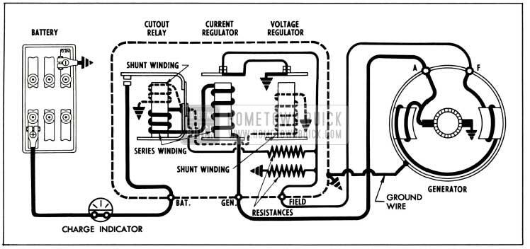

953 nut 61,320 #4 Posted Thursday at 11:24 AM (edited) A three terminal voltage regulator like the ones used on GM cars and trucks from 1955 to about 1972 can be used. They do not have the "L" terminal but will do the job and will probably be more affordable. Edited Thursday at 11:09 PM by 953 nut fat finger 5 Share this post Link to post Share on other sites
