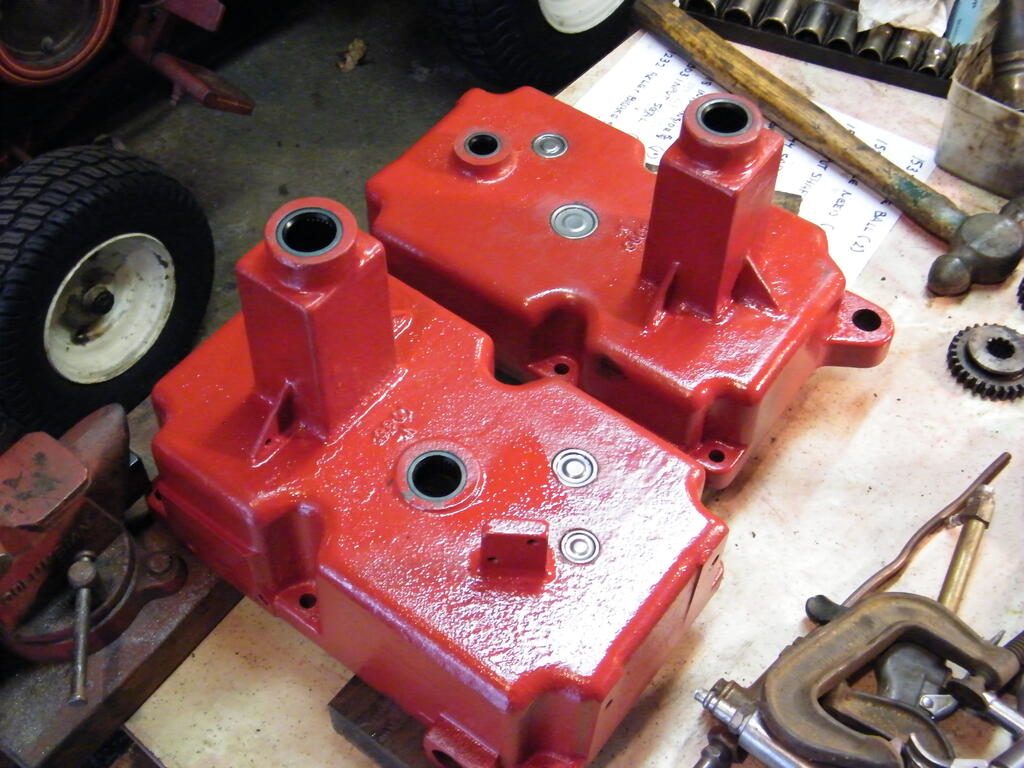

stevasaurus 23,533 #2 Posted October 1, 2025 All right, I'll start. I believe the cap bearing should be tapped or pressed into the hole in the casting from the outside to a point where the bearing is flush with the outside of the casting. Here is a couple of pictures...Burrly1's #5007 transmissions. The 1st thing to admit...this is a nice look. 5 Share this post Link to post Share on other sites

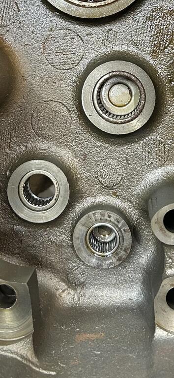

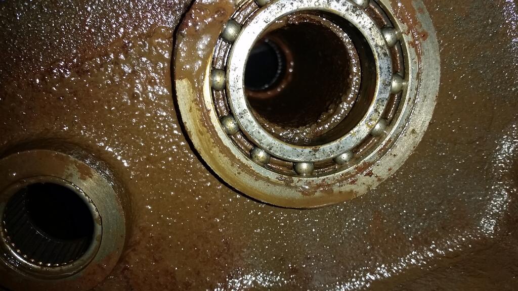

squonk 45,049 #3 Posted October 1, 2025 (edited) Un-molested bearing on my 857 trans.As I know it has never been apart. The bearing edge is about a 1/16" in from the case edge. Same as the 2 transmissions I worked on. Al little closer to the edge is probably better than too far in. Edited October 1, 2025 by squonk 4 Share this post Link to post Share on other sites

JoeM 9,387 #7 Posted October 2, 2025 last two i did were set flush on inside I figured the inside is machined to a tolerance ?? before pic 3 Share this post Link to post Share on other sites

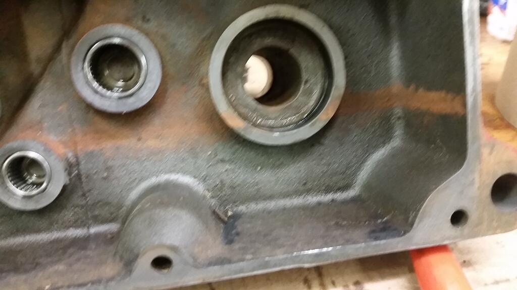

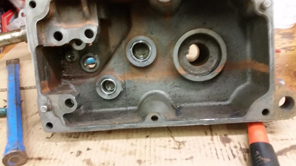

WHX?? 53,672 #10 Posted October 2, 2025 (edited) A 5060 original never been opened. First one I ever had apart other than a three piece. I took them pics so i would know how the replacements should be in. Last pic looks to be an open one tho. Edited October 2, 2025 by WHX?? 2 Share this post Link to post Share on other sites

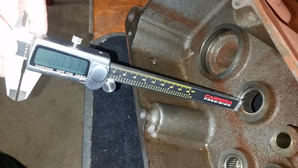

stevasaurus 23,533 #17 Posted October 2, 2025 I'll add this at this point. All of the manual Wheel Horse transmissions use 3 cap bearings (the 3,4,6 &8 speeds)...and they all have a depth of 3/4" on the package. I happen to have a #5053 3 speed tore down in the garage, and guess what? All of the holes that would have cap bearings (the castings) measure 3/4" inside to outside. The cap bearings that I pulled out actually measure a depth of 11/16". That tells me, we are haggeling about where you want to hide that 1/16". Looks like it does not really matter wether you set them flush with the inside or the outside. For me, I like the look of the bearings set flush to the outside of the casting. The one thing you don't want is that cap bearing set too deep that the shaft it holds is riding in the end of the cap it self. I think I will agree that the factory set them flush to the inside. 4 Share this post Link to post Share on other sites
