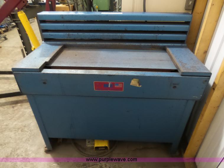

Cheap Cylinder Head Mill!
Pullstart
Check this out!  It all starts with a clothes hanger :lol:

That type of machine was available for many years.  I took a pair of heads to a shop and after they were sanded I could get a .012" feeler gauge between them when placed face to face.  I all depends on how flat the platen is.  Just because it is glass doesn't mean that it is flat.

First - that is not a milling process. It is sanding. Milling the mating surface of a head usually involves precision fixturing and linear motion of either the part or the head of a rotary flycutter.
No switching belt grits from cut to clean to finish pass as most of us do with K series heads??
Material removal is one thing, but what is the surface finish that is the end result?? This ties in with Don's reply - part of the tolerance will be taken up by the microscopic peaks & valleys. The rougher the surface, the more of the allowable tolerance is eaten up....  :twocents-02cents:

Of course I could have checked the heads on a surface plate using feeler gauges or an indicator, but I did a quick check right at the machine shop and handed them right back.  They were better than that before he sanded them.  He has a proper milling machine that was used to get them right.
These cast iron heads use a thin metal gasket so they need to be right.  It is surprising just how bad a head can be and still be pulled down with the head bolts, but I didn't want to be a test case.  I have read various tolerances for aluminum, iron, 6 cylinder, etc. but there is no excuse to have the flatness out more than a couple of thousandths.
