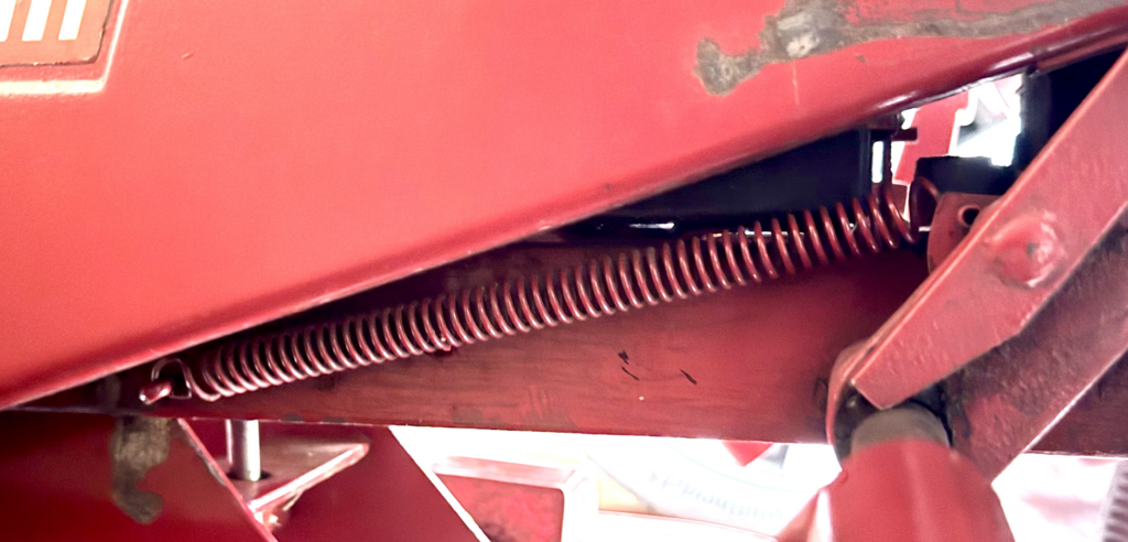

Simplecity 23 #1 Posted September 29, 2025 (edited) Good Day All Have a couple of years of on and off searching, I found a RM367 mower deck in decent shape considering it was outside under a pile of vines. Blades were installed backwards (left/right reversed) but the deck appears to have been undercoated. Anyway, all it needed was a set a belts and blades sharpened. My question concerns the return spring for the attachment clutch pedal: Where does it attach? If I attach it to housing on the clutch pedal (where the trip leveris mounted) it binds and trip lever wont lock when it releases the belt. Currently I have it attached to the hair pin on the inner hole of the trip lever that holds the clutch link. This 'spring loads' the trip lever to the release position. It works, but Im sure that is not how it was originally. I have both the the Operation and Service Manuals for the tractor and the mower, but it really doesn't address this. Also, trying to run down a set of replacement blades to have on hand. Haven't been able to track part numbers from the original 4116/4117 other than a 8014 Toro blade kit that, for what ever reason, averages about 120 bucks. If this all there is, I'll bite the bullet. If there are other alternatives, let me know. Thanks to all who respond. Pictures would be a bonus. Simplecity Edited September 29, 2025 by Simplecity Share this post Link to post Share on other sites
squonk 45,893 #2 Posted September 29, 2025 It clips on the cotter pin on the pedal linkage and another cotter pin on the frame 3 Share this post Link to post Share on other sites

Handy Don 16,109 #4 Posted September 29, 2025 (edited) 56 minutes ago, squonk said: It clips on the cotter pin on the pedal linkage and another cotter pin on the frame Loop head of a cotter pin at both ends. Simple and effective. Other blade numbers: 7906, 7907 NOS (I don’t know if these have a different shape or not) Try https://davespartsworld.com. He had at least one 8014 set at the Big Show Edited September 29, 2025 by Handy Don 3 Share this post Link to post Share on other sites
Achto 31,416 #5 Posted September 29, 2025 1 hour ago, Simplecity said: Currently I have it attached to the hair pin on the inner hole of the trip lever that holds the clutch link. This 'spring loads' the trip lever to the release position. It works, but Im sure that is not how it was originally. Pic below shows the correct spring placement on the engagement peddle. The spring puts rotational tension on the trip lever as well as putting tension on the PTO belt. 1 1 1 Share this post Link to post Share on other sites
kpinnc 17,580 #6 Posted September 29, 2025 And use steel cotter pins... 4 Share this post Link to post Share on other sites

Simplecity 23 #11 Posted September 29, 2025 Thanks to All who responded, especially Achto for the pic. Basically I have it correct, just need to relocate it to the outside hole and use steel cotter pins instead of the hair pins. Also thanks for the leads on blades. I have seen blades for the 32" deck on Flea Bay that were RESONABLE priced. There is a small independent mower repair shop in town that deals with STENS. I will see what he has to offer. Thanks again Simplecity 1 Share this post Link to post Share on other sites
