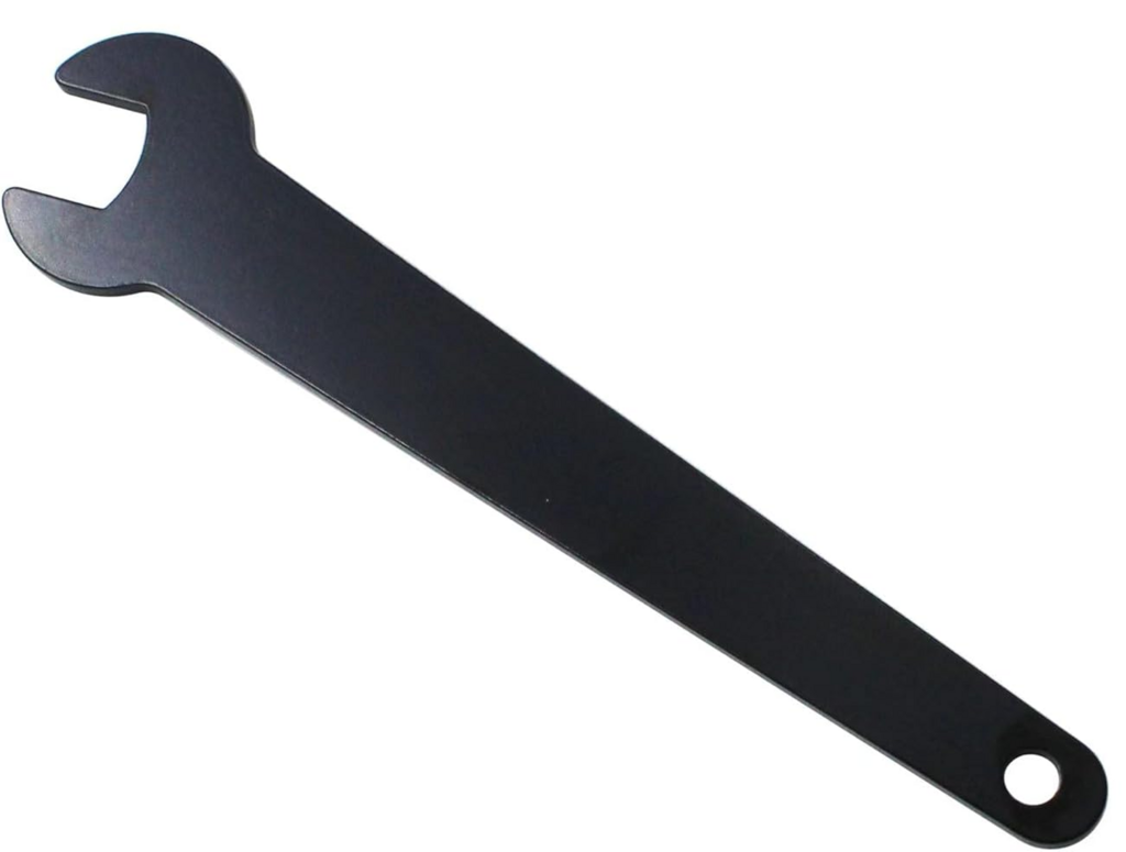

rmaynard 17,017 #5 Posted September 29, 2025 I use the wrench from my table saw. It's the correct size and is thin enough to fit without binding. 2 1 Share this post Link to post Share on other sites
ebinmaine 77,973 #6 Posted September 29, 2025 16 hours ago, wallfish said: It's 3/4" 5 hours ago, rmaynard said: I use the wrench from my table saw. I r not as smartererer I struggled with a pair of needle nose pliers. You guys and your simple solutions..... 2 1 Share this post Link to post Share on other sites
wallfish 19,533 #7 Posted September 29, 2025 4 hours ago, ebinmaine said: I struggled with a pair of needle nose pliers. You guys and your simple solutions..... That's exactly why it's good to have some of those cheap crappy tools around. I have no problem grinding or bending or both on them to make unique tools when needed. Wrenches, screwdrivers, pliers etc etc. You name it. Don't be scared to pay a dollar for some cheap tools that can be modified without remorse. A modified wrench works good for those carb bolts too. 1 1 1 Share this post Link to post Share on other sites
