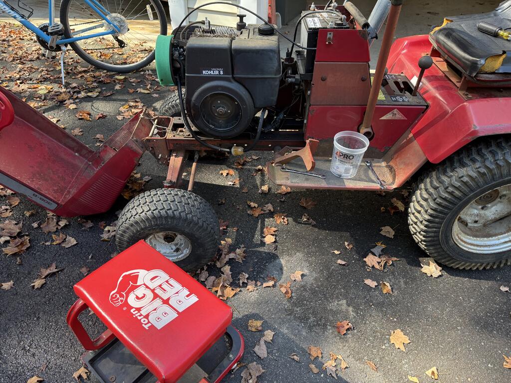

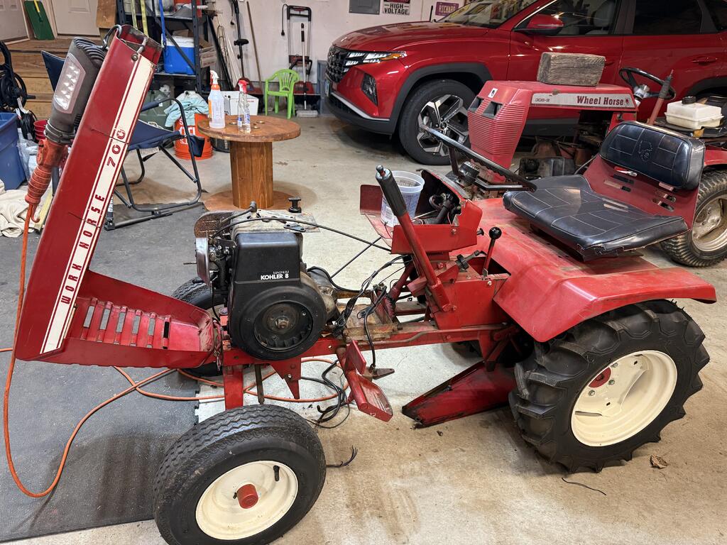

Sparky-(Admin) 24,848 #1 Posted September 28, 2025 Yanked the motor for a project, any tips on tank removal ? 1 Share this post Link to post Share on other sites
peter lena 9,812 #2 Posted September 28, 2025 @Sparky opportunity , washer up the sloppy start of your PTO LEVER , side of the battery tray , like a gold mine for improvement's, would also consider running a frame length steel fuel line , eliminate lots of fuel hose break down , auto brake line tucks right in the upper corner of the frame , that pto lever rod , used a 3/8x24 die nut , ran right over original 3/8x16 threads , heim screwed right on . also did my related , mule drive bearings , clean out , lucas xtra hd , green chassis grease , mower deck added belt idler , stop belt bounce , pto outer swing mount , lube , extension spring , to hitch pin clip ,on frame , stops lever rod attachment noise . like said , a GOLD MINE for improvement . this area , made me a convert , for reliability , worth a look, pete Share this post Link to post Share on other sites

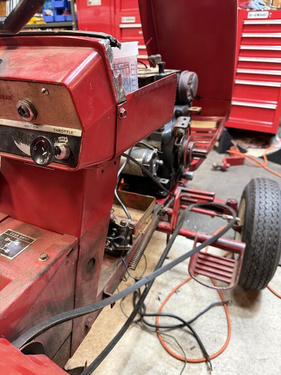

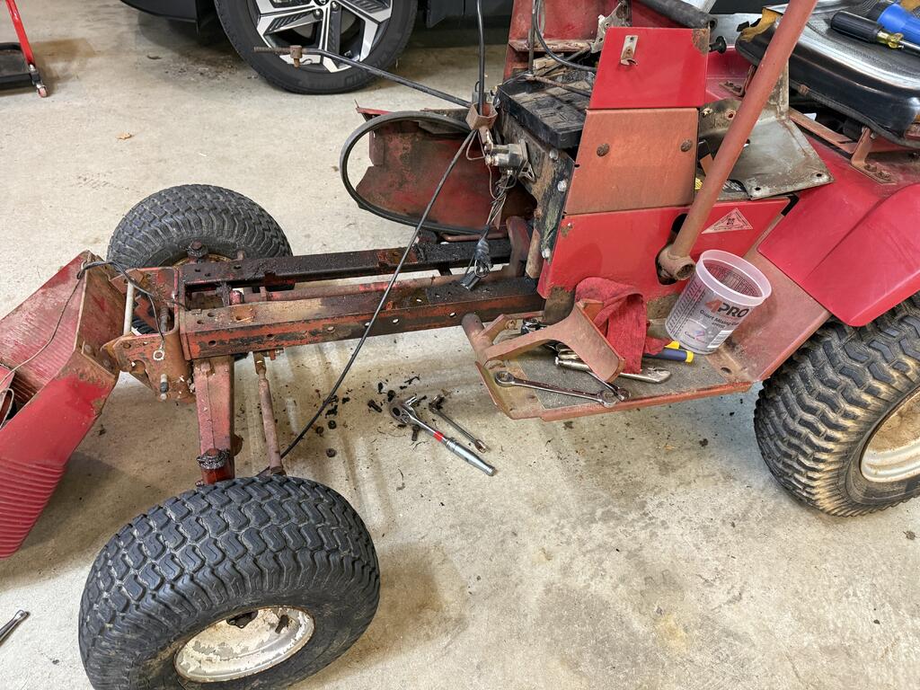

Sparky-(Admin) 24,848 #3 Posted September 28, 2025 Tank is out…requires starter removal. And unknown to this guy the starter “popped open” once it was out ans in my hand and getting it back together and those 4 little magnets back in place was a complete nightmare! But I won after much swearing This is the tractor that will be getting the Mag8. The current motor is a tired Teccy HH70. 1 Share this post Link to post Share on other sites

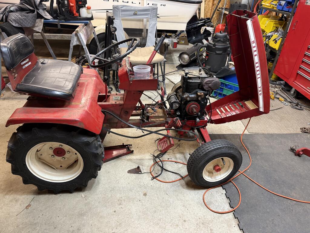

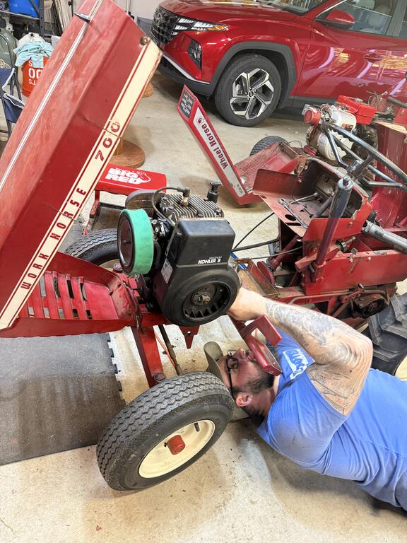

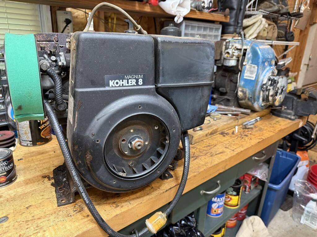

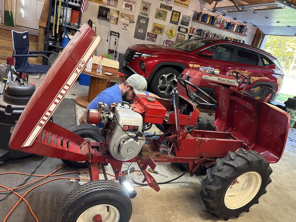

Sparky-(Admin) 24,848 #8 Posted September 28, 2025 Magnum is in, had to move it forward to clear the battery and the fuel tank isn’t going to work. Choke and throttle all set, wiring harness moved over but not hooked up. But I have it all figured out in my head . Have a fuel tank that will work. Belt will be interesting. 1/2” on the tranny input and idler pulley, 5/8” on the motor. Will need a new 1” ID pulley on the Magnum. Would like a 3” to increase ground speed just a wee bit. Father son project, good times! 7 Share this post Link to post Share on other sites

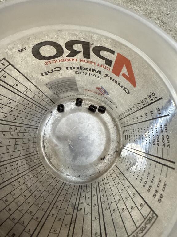

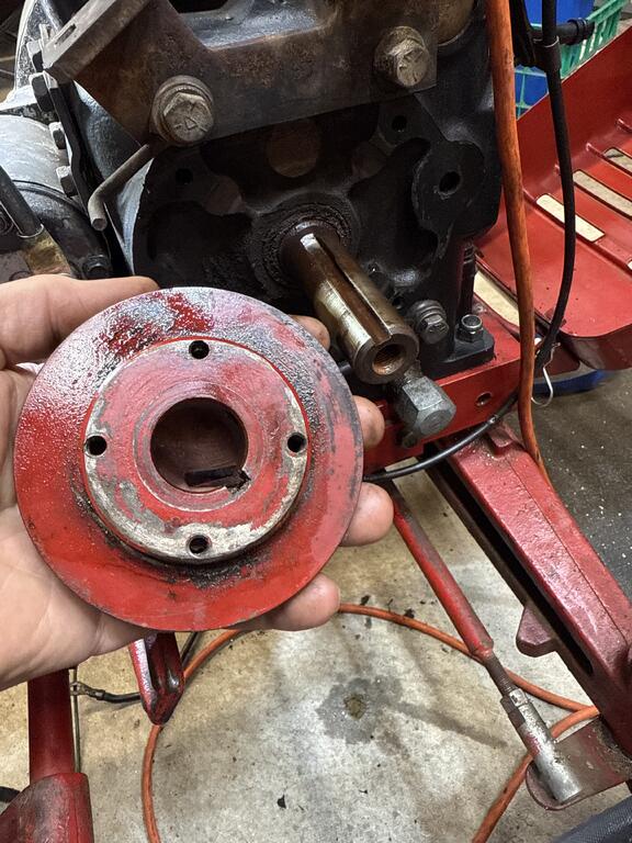

Sparky-(Admin) 24,848 #13 Posted September 29, 2025 Got the wiring sorted so I have it cranking. Then prepped myself for the drive pulley removal..well that sucker came right off with minimum effort! Is it normal to have two set screws on both set screw holes?? 1 Share this post Link to post Share on other sites
wallfish 19,533 #14 Posted September 30, 2025 1 hour ago, Sparky said: Is it normal to have two set screws on both set screw holes Not always but always check before assuming it's only one in there. Seems like someone was in there before too because that key looks wonkie. Factory key is gonna be flat and square. Maybe they added the set screws too Share this post Link to post Share on other sites
Sparky-(Admin) 24,848 #15 Posted September 30, 2025 22 minutes ago, wallfish said: Not always but always check before assuming it's only one in there. Seems like someone was in there before too because that key looks wonkie. Factory key is gonna be flat and square. Maybe they added the set screws too Yeah, the key was rough looking. Share this post Link to post Share on other sites

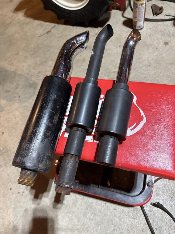

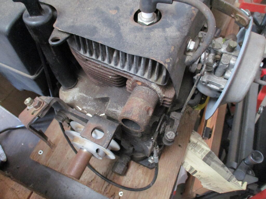

Sparky-(Admin) 24,848 #20 Posted September 30, 2025 What’s behind this muffler on my Magnum 8? Standard 1” threaded port? I know, I know….just take it off and see. But I’m at work thinking about tractor stuff and not thinking about submarines right now 🤣 Share this post Link to post Share on other sites
WHX?? 55,834 #21 Posted September 30, 2025 2 hours ago, Sparky said: not thinking about submarines right now 🤣 Oh My ... 1 Share this post Link to post Share on other sites
pfrederi 20,136 #22 Posted September 30, 2025 1" Black iron pipe there are also 2 threaded holes for a bolt on muffler 1 1 Share this post Link to post Share on other sites

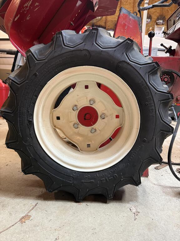

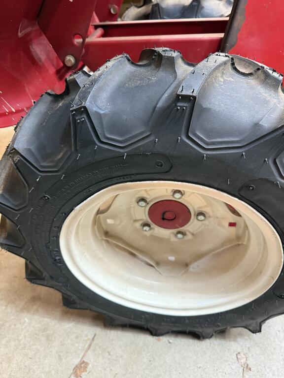

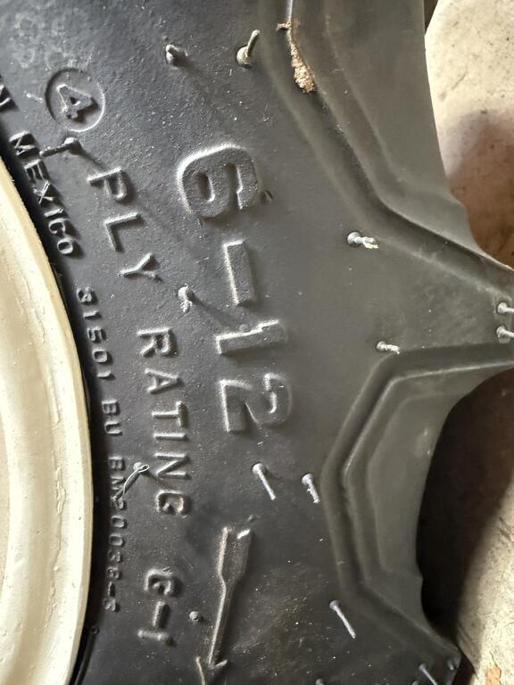

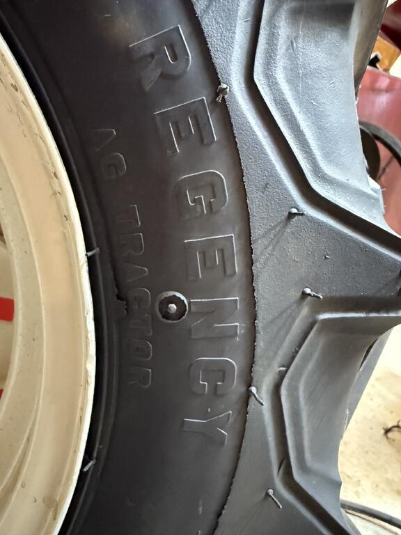

Sparky-(Admin) 24,848 #23 Posted September 30, 2025 22 hours ago, WHX?? said: There fixed that ... Man Jim! If ya had the brand name right I mighta boxed up the tires and sent em your way. Firestones These are Regency 6x12’s, real nice tires. @WHX?? 1 2 Share this post Link to post Share on other sites
Retired Wrencher 6,537 #24 Posted October 1, 2025 12 hours ago, Sparky said: Man Jim! If ya had the brand name right I mighta boxed up the tires and sent em your way. Firestones These are Regency 6x12’s, real nice tires. @WHX?? Wow Mike those look to be a bit aggressive or am I missing the boat on this. Share this post Link to post Share on other sites
Sparky-(Admin) 24,848 #25 Posted October 1, 2025 12 minutes ago, Retired Wrencher said: Wow Mike those look to be a bit aggressive or am I missing the boat on this. They are aggressive, it’s the “look” my son wanted for his show cruiser. He also wants a small stack and I have a few of the Jim Kemp types here laying around. 1 Share this post Link to post Share on other sites
