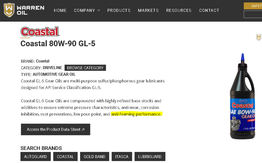

JoeM 9,650 #7 Posted September 27, 2025 Maybe the gear oil used has a anti foaming additive problem. For little money, might want to change it again and use a different brand. At least contact the oil mfg. and ask about the problem. 1 Share this post Link to post Share on other sites
C100_NY 1 #8 Posted September 27, 2025 I am thinking about trying some john deere brand gear oil. I used coastal which is a cheaper brand. Share this post Link to post Share on other sites

JoeM 9,650 #10 Posted September 27, 2025 (edited) 1 hour ago, C100_NY said: I used coastal which is a cheaper brand I have used it and had no issues. Coastal is a Warren Oil Co. their reputation is pretty good. web site https://www.warrenoil.com/ourproducts/Coastal80W-90GL-5-d Edited September 27, 2025 by JoeM Share this post Link to post Share on other sites
