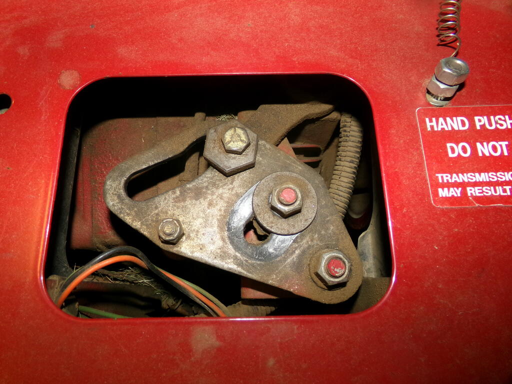

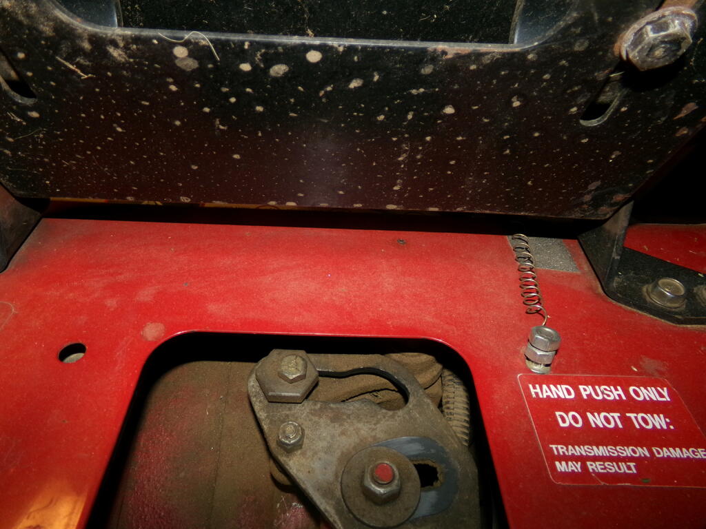

Ed Kennell 45,043 #5 Posted September 25, 2025 This is the motion control cam on the Eaton 1100 hydro. Check that the cam has full forward and reverse travel. Full forward Full reverse 2 1 Share this post Link to post Share on other sites
