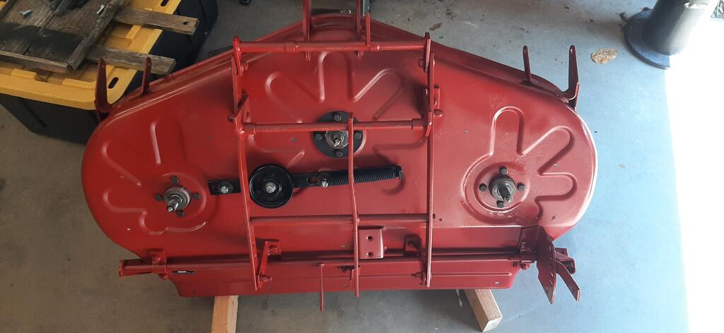

John c 135 #1 Posted September 19, 2025 Does anybody know the torque spec for the alloy spindle housings I'm getting near done on my 42RD rehab project I'm asking about the 4 3/8" bolts on each of the housings Share this post Link to post Share on other sites
peter lena 9,715 #2 Posted September 19, 2025 @JOHN C. just curious , did you add another idler pulley to the backside of the idler pulley belt return ? like this , that long , USUPPORTED RUN is a major cause of bearing issues .very easy to set up , and very effective , did that years ago , experimenting with ,REPEDITIVE PROBLEM , added that to my 3 decks , no problems , pete Share this post Link to post Share on other sites
gwest_ca-(File Mod) 11,981 #3 Posted September 19, 2025 3/8" - 16 bolts in aluminum dry torque 12.4 ft lbs = 148 in lbs Lubricated threads 9.3 ft lbs = 112 in lbs 3 Share this post Link to post Share on other sites
John c 135 #4 Posted September 19, 2025 Thank you GW Pete, Not yet, I want to run it first to figure out placement, you'll be proud I stuffed those housings full of green lucas. 1 Share this post Link to post Share on other sites

peter lena 9,715 #7 Posted September 20, 2025 @Johnc glad for the lucas green . been absolutely bombproof for me , as far as the added idler goes , you do not need much push back on that belt , that area is just right , for light push back , placed the pully on deck at best spot to be able to gain from its placement , as slight as it is , it removes that shuddering bounce . just drilled a hole used a 3/8 smooth shoulder bolt, no threads on bearing spin area , washer under deck and washer on top of pulley with an elastic lock nut . my regular reference to belt and bearing issues , have eliminated my problems . by the way did you clean out and re grease the mule drive bearings ? same scenario , those 6203 bearings , wide grease shields , really do stand up with lucas green . typically a horse problem , is multi staged , not just one spot / but related / connected . done a lot of that , thanks for the shout , let me know , pete Share this post Link to post Share on other sites
