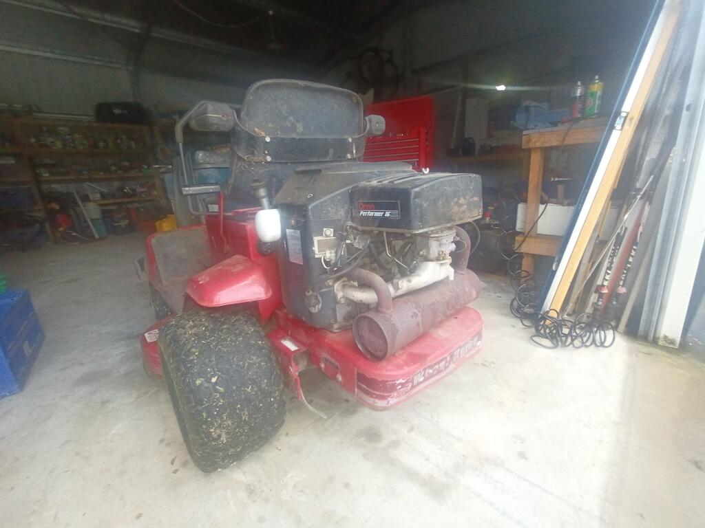

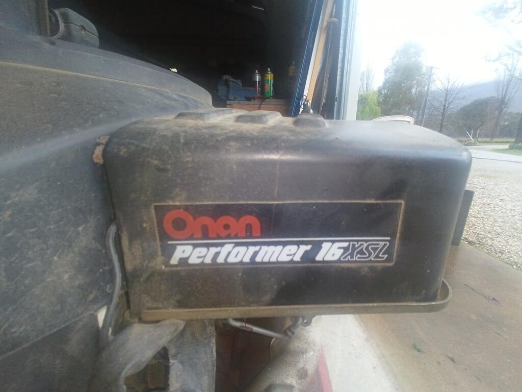

Stephen Williams 0 #1 Posted September 16, 2025 Hi, I have a Wheel Horse with an Onan16XSL engine, I bought it about a year ago and it ran fine for the first six months, however now the inlet valve on one cylinder has developed an annoying and puzzling (to me) problem. The valve tappet adjuster starts to slowly wind itself in until it opens the valve that much that the engine looses compression on that cylinder and of course power. I have readjusted it a few times but after 3 or so hours of use it needs readjustment. I've asked mechanics about it and they haven't heard of this sort of problem, no one has any idea why it happens, Any suggestions? Thanks. Share this post Link to post Share on other sites
