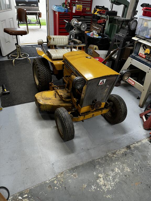

p38js 441 #1 Posted September 16, 2025 My first thought when someone mentions a garden tractor is my grandfathers 1965 Big Ten, as a young kid I can vividly remember my dad and grandfather hauling fire wood out of the woods across the meadow to the where he stored and stacked his fire wood. I can remember when I got to drive the Big Ten for the first time, I was king and he was there to show me how to mow and how to change the oil and how to remove the deck and put the plow on to turn the garden. So I was set on a mission to find a Big Ten. He sold his and upgraded to a 716. I tried to search for his but I got to two owners than it just disappeared. So I found this one in Erie, Pa. I dragged it home and showed him what I got I was so proud of myself for finding it and getting it running, I was able to get him on the tractor at 90 and he had a huge smile and talked about that tractor and memories he had. It is always amazing to me the attachment me have to just a simple little tractor. I was not able to get a picture of him back on a Big Ten, I made a promise to myself to redo this little tractor and show him but I didn’t make it. So it sat in my shed for a couple of years and now I’m ready to get this done. Started the tear down and these tractors are a lot more complex than wheel horses. I really enjoy the simplicity of wheel horse. I guess that is why wheel horse is so popular they are easy to work on. 7 5 1 Share this post Link to post Share on other sites

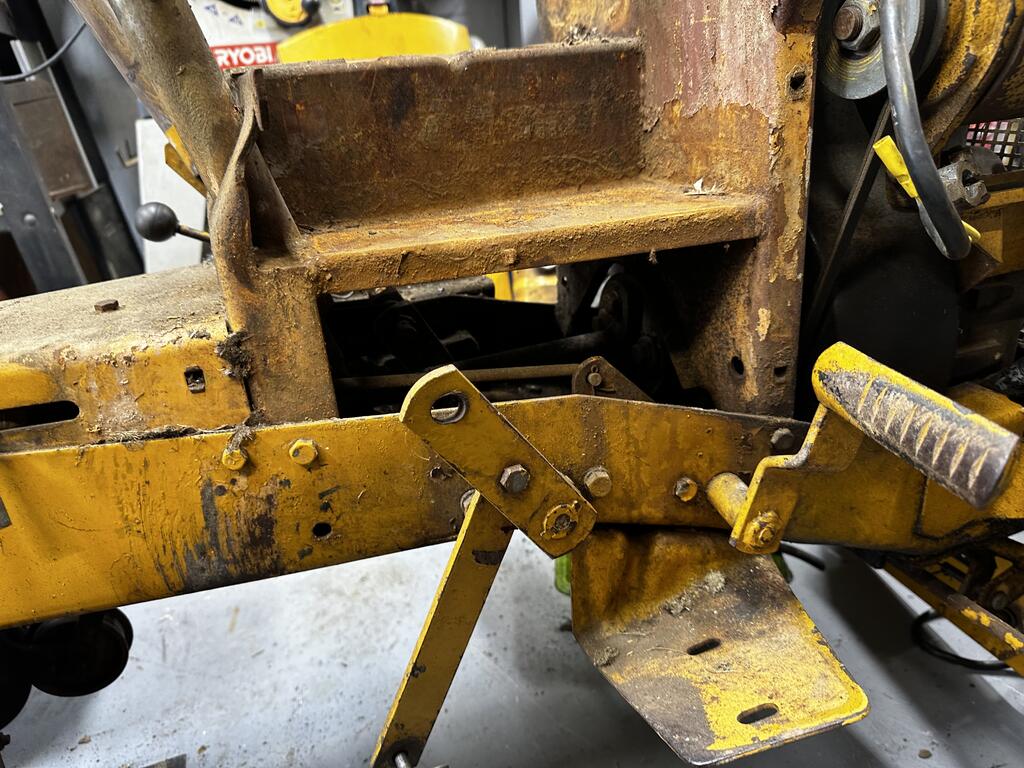

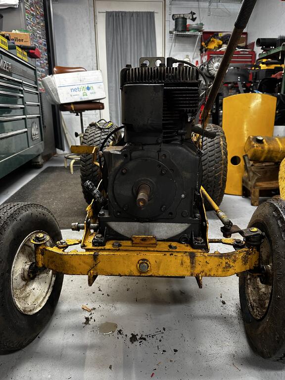

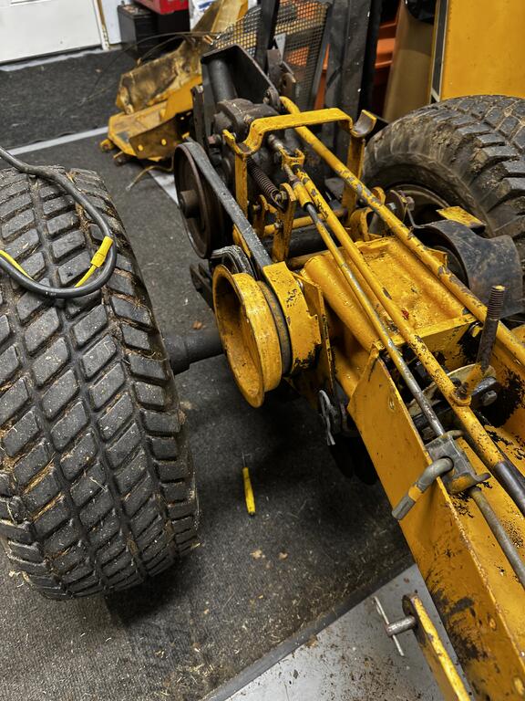

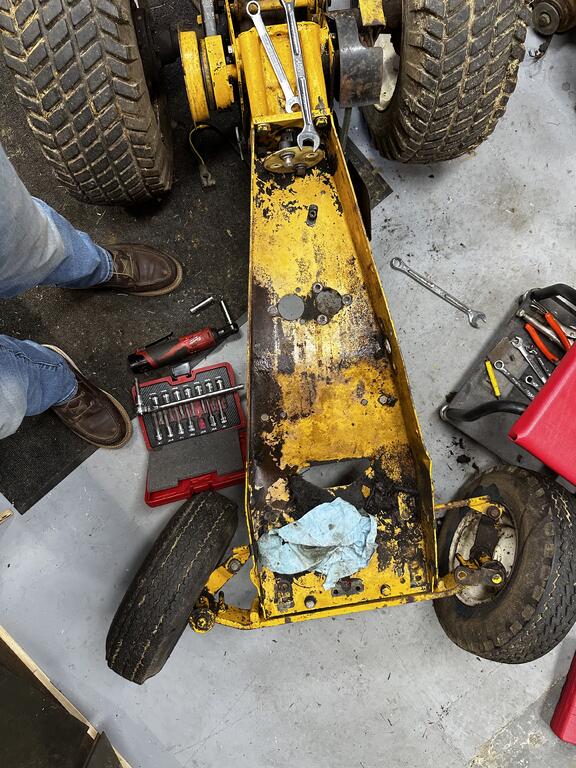

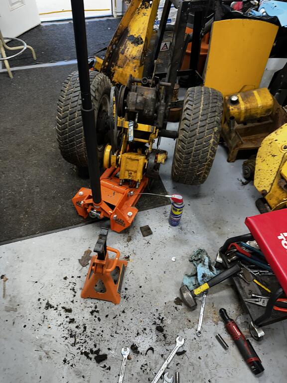

p38js 441 #6 Posted September 17, 2025 Got a little farther today, the accessory drive pulley must have been on since the beginning of time. It took a puller a 2ft breaker bar and a 3ft crow bar to get it off it sounded like a gun shoot when it finally decided to move. Looks like the the tractor has been repainted at some point in its life. Also I’m pretty sure it had an engine change at somepoint also. It took a lot of heat and a large pipe wrench with a cheater bar to get the exhaust off. All things considered with a 60yr old tractor she is in pretty good shape. Share this post Link to post Share on other sites

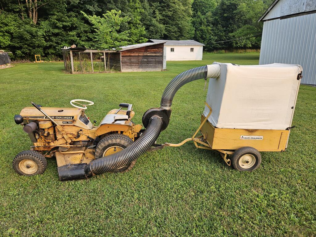

Mike'sHorseBarn 3,416 #7 Posted September 29, 2025 I had a big ten with a lawn vac on it. I miss the tractor but not the vac lol 2 Share this post Link to post Share on other sites
p38js 441 #8 Posted September 29, 2025 That looks like a nice setup Share this post Link to post Share on other sites

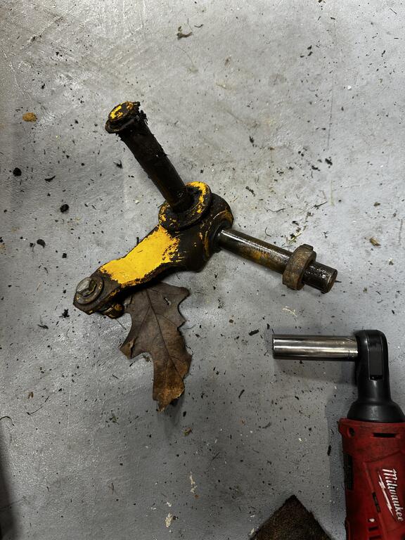

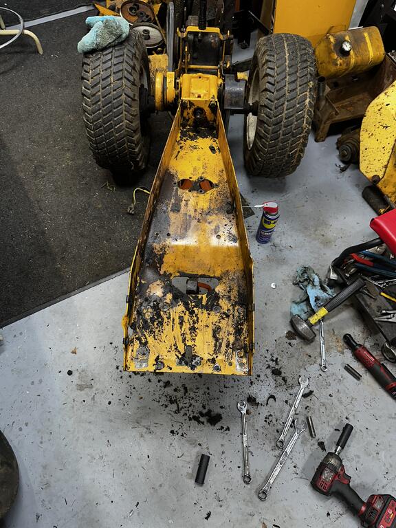

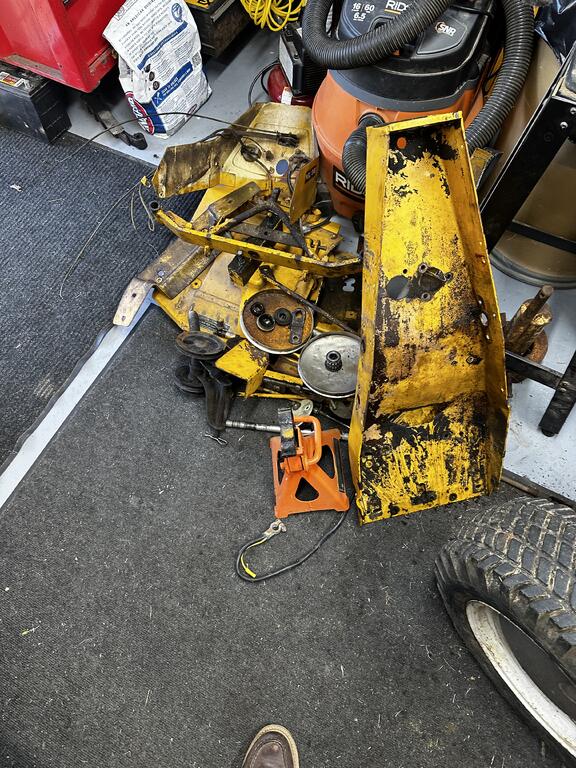

p38js 441 #9 Posted October 3, 2025 After a good power wash it looks pretty good, was tossing around of the idea of just repairing the worn out parts and enjoying the tractor now. But after inspection this was already repainted at some point. So onward with the tear down Share this post Link to post Share on other sites

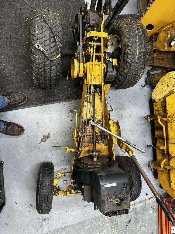

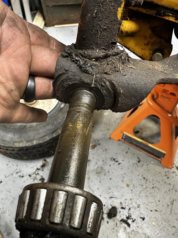

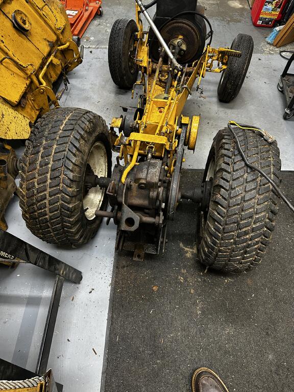

p38js 441 #10 Posted October 8, 2025 Well where once a tractor stood there is only a pile of parts. For being 60 years old she is in pretty good shape, I can not believe how dry the bearings are and I pretty sure there is no oil in the bevel gear box. But there is plenty of grease on the outside to prevent corrosion. I guess that is a good thing? Share this post Link to post Share on other sites
