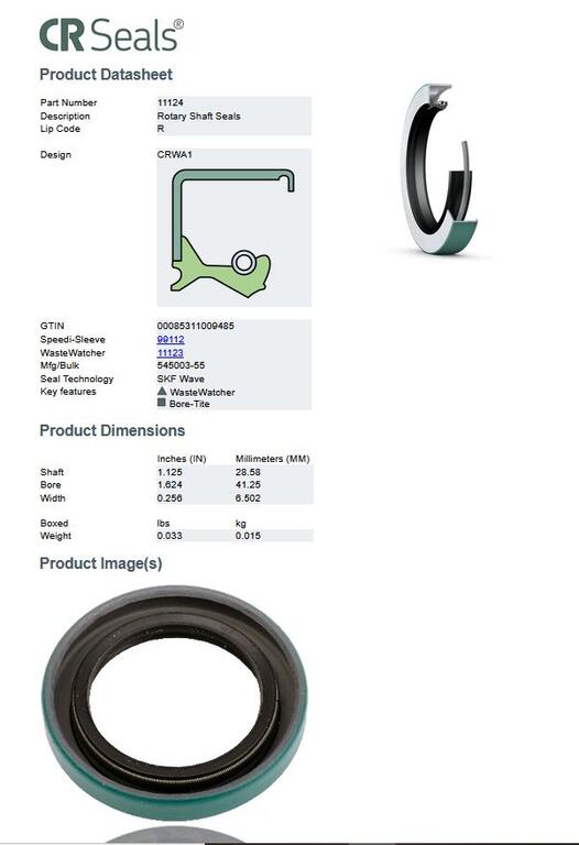

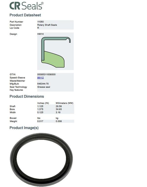

pfrederi 19,794 #5 Posted September 16, 2025 (edited) 15 hours ago, WHX?? said: You lost me Paul which is fairly easy to do but are you saying the seals aren't 1 3/8 OD? WH#6449was seal used in Sunstrand and Eaton Hydros ...Bore 1.624 CR 11124 WH 100443 used in gear drives Bore 1.375 CR 11050 I guess WH wanted a spring to help hold in the thinner fluid??? Edited September 16, 2025 by pfrederi 2 Share this post Link to post Share on other sites

pfrederi 19,794 #7 Posted September 16, 2025 1 minute ago, Handy Don said: The thread started on the question of "why are the outer dimensions of the castings for hydro vs.8-speed different at the place where the front blade bracket attaches?" Nothing directly to do with bearings or seals. Maybe if WH decided they wanted to use a larger diameter seal they thought there was insufficient casting at the end of the axle housing to put it in so the made the axle housing a bit bigger??? 1 1 Share this post Link to post Share on other sites
