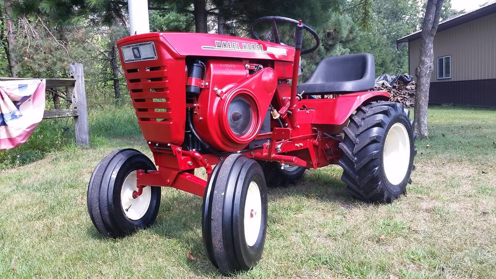

What tractor we talkin here? Got any pics?  Many of us run. 4 -8s with no problems on stock rims.
this tractor has 4-8s the second one has tires Achto mentioned.

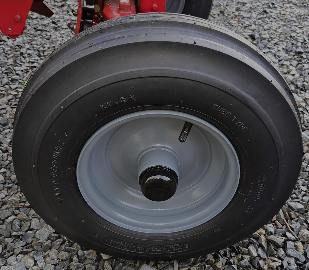

I have a set of the crazy expensive Firesones, and while they are nice- the cost is just silly. I didn't pay that much for mine many years ago.
Deestones are much more affordable, and seem to be good tires.
Even if your rims are wider, you can find a set of narrow rims for less than the cost of Firestones. Personally, I think the Deestones look more accurate to scale.
How old are yours KP?  Any problems with them seating on the bead? Any problems with them cracking on the sidewalls?
I got them for the Bronco restore, so at least 13 years ago?
I put tubes in mine from the start. No cracks so far, but this tractor lives indoors.

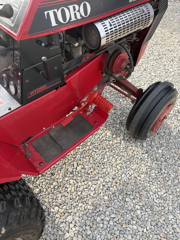

Tonytoro416
These are the firestones thankfully they came on the 416 when I bought so I didn’t have to bite off the big chunk of change

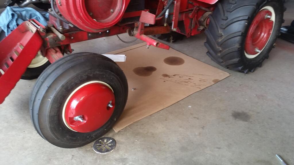

Jim, I can relate to that. I just feel that good money can be spent on other things that the tractor may need and most of the time the ones I have just sit around and do nothing. There’s one trick I learned from my brother he did some research because he has a classic cars.He said the best thing you can do for tires is put a rug or a piece of cardboard underneath them that’s what he told me and that’s what I did. So far so good. I guess time will tell the story on this. It’s been a few years.
