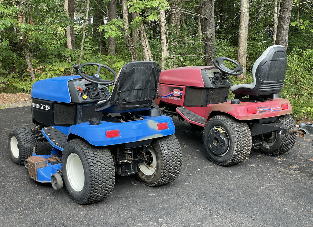

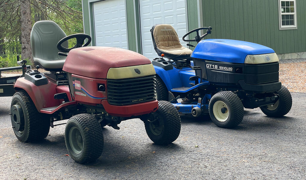

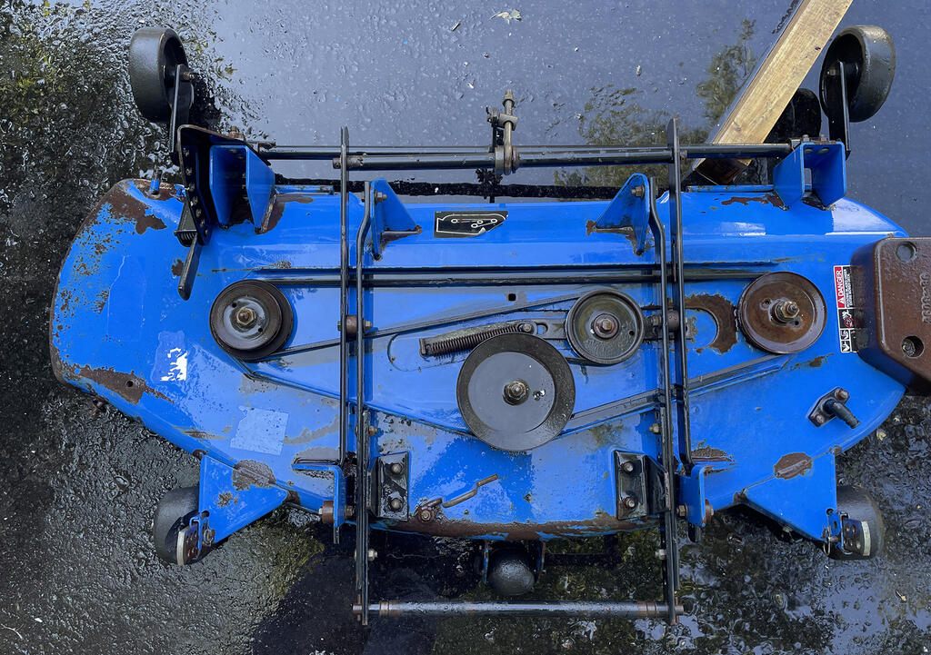

Blue Chips 701 #1 Posted September 1, 2025 Hello everybody. I’m new to the forum, but I’ve owned a 2001 522xi for the past 17 years, which has served me well for multiple purposes, including snow removal, rototilling, lawn mowing, and moving my empty flatbed trailer around the yard. I also have a plow for it, which I've never used, since I have other equipment for pushing stuff around. I recently added a new member to the stable: a New Holland GT18, which I understand (correct me if I’m wrong) is basically a Toro Wheel Horse 518xi wearing a blue suit and sporting a few trim and logo differences. The new-to-me GT18 came with a very solid 48-inch mowing deck (no deep rust or rust holes), which is one of the main reasons I bought it. The tractor runs well and has less than 400 hours on it. However, the tractor and mowing deck were both in need of a some repairs and adjustments, which I’m currently in the process of taking care of, and I'll post that process soon. 5 4 Share this post Link to post Share on other sites

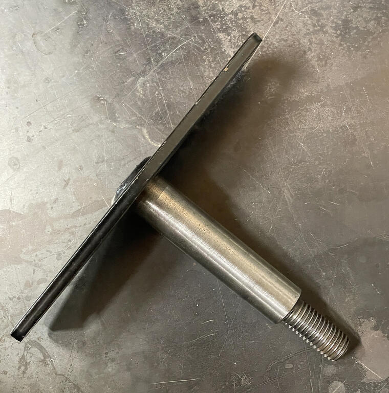

Pullstart 68,899 #8 Posted September 1, 2025 I’m sure you know this, but make sure to jack the front end up BY THE FRAME and inspect that front axle pivot. They are a weak point in the design of these beasts! 2 2 Share this post Link to post Share on other sites
Blue Chips 701 #11 Posted September 1, 2025 2 hours ago, Pullstart said: I’m sure you know this, but make sure to jack the front end up BY THE FRAME and inspect that front axle pivot. They are a weak point in the design of these beasts! Per your suggestion, I just pulled the front axle pivot pin to inspect it. All of the fasteners were nice and tight, so I don't think it has been shifting around. The pivot shaft is still in good shape, and there was no damage to the hole where the threaded portion of the shaft passes through the frame member. I lightly polished the shaft, cleaned it, greased it, and reinstalled it. The axle pivot action seems very smooth and snug. 5 4 Share this post Link to post Share on other sites
