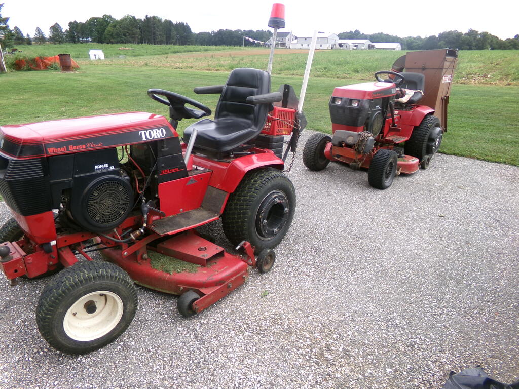

Lee1977 7,630 #4 Posted September 1, 2025 Here is a picture of a 312-8 with 8" wheels on the 6" spindle. Mower deck still works just need to adjust the rod. 3 Share this post Link to post Share on other sites
Ed Kennell 45,524 #5 Posted September 1, 2025 Same set up on my 310 and 312. 2 Share this post Link to post Share on other sites
