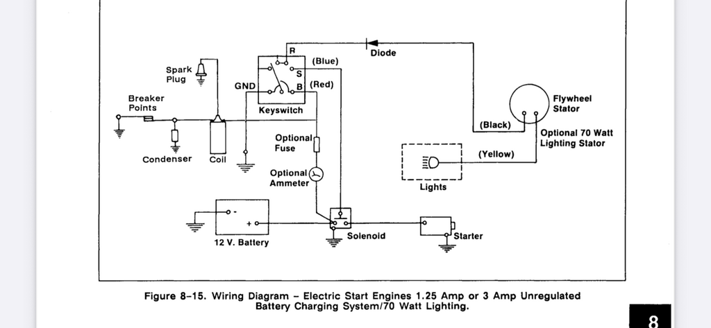

C100_8 25 #11 Posted September 3, 2025 I think I found the issue. I believe the new engine has a diode on one of the lines as shown in the diagram below. Can I just bypass the rectifier completely and run the diode line directly to the switch as shown. Does anyone know if there is a different switch for this kind of charging system? Share this post Link to post Share on other sites
953 nut 64,108 #12 Posted September 3, 2025 You need to know the SPEC # and Serial number of the replacement engine, look it up to find out what it came from and use the wiring diagram / ignition switch information from that. 1 1 Share this post Link to post Share on other sites
ebinmaine 77,323 #13 Posted September 3, 2025 16 minutes ago, 953 nut said: You need to know the SPEC # and Serial number of the replacement engine, look it up to find out what it came from and use the wiring diagram / ignition switch information from that. Seconded Share this post Link to post Share on other sites
953 nut 64,108 #14 Posted September 3, 2025 On 8/31/2025 at 5:11 PM, C100_8 said: The charging system worked fine on the old engine. One option would be to use the flywheel and stator from your old engine on the replacement engine and then there wouldn't be any wiring changes needed 1 Share this post Link to post Share on other sites
