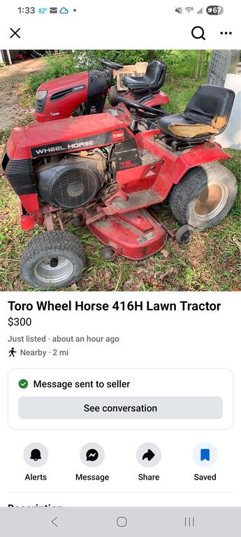

RED-Z06 2,720 #1 Posted August 30, 2025 Popped up 2 miles away, jumped in my old truck, hooked up the trailer..pulled out to the shop to grab a couple straps and brake pedal went to the floor. As rare as it is for anything decent WH to show up here...my truck absolutely let me down. 1 3 Share this post Link to post Share on other sites

RED-Z06 2,720 #5 Posted August 30, 2025 1 minute ago, 953 nut said: How fast can you run two miles? Don't let a little brake problem stop you! If 400/500s had a true freewheel we might have seen how fast one can go being towed behind a Z06 "This is lawnmower landspeed, im Tommy Knoxville, welcome to jack@ss" 1 4 Share this post Link to post Share on other sites

RED-Z06 2,720 #9 Posted August 31, 2025 55 minutes ago, John c said: I believe I'da at least went and looked at it in another vehicle, if it was worth it made a deal, and explained the brakes situation on my truck. Then gone back to pick it up. Or something along those lines He had a line of people waiting to buy, i haven't driven my car in 2 months, its just been sitting under the cover, it was listed as sold within 20 minutes of me saying i couldn't make it there on time. This morning i pulled the car out, checked the fluids, had a soft tire, and washed it...so at least i can go places until the trucks sorted. 2 Share this post Link to post Share on other sites
