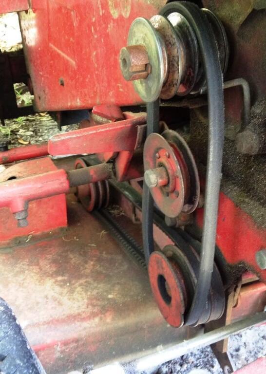

looking for the idler that connects from the foot clutch on the right side of the machine, to the deck. idk if this is one where i can replace the bearings but it needs addressed soon.
heres a picture of what it looks like on another redsquare users post. a part number and maybah somewhere to buy they pulley or bearing would be awesome.

triple grooved my bad

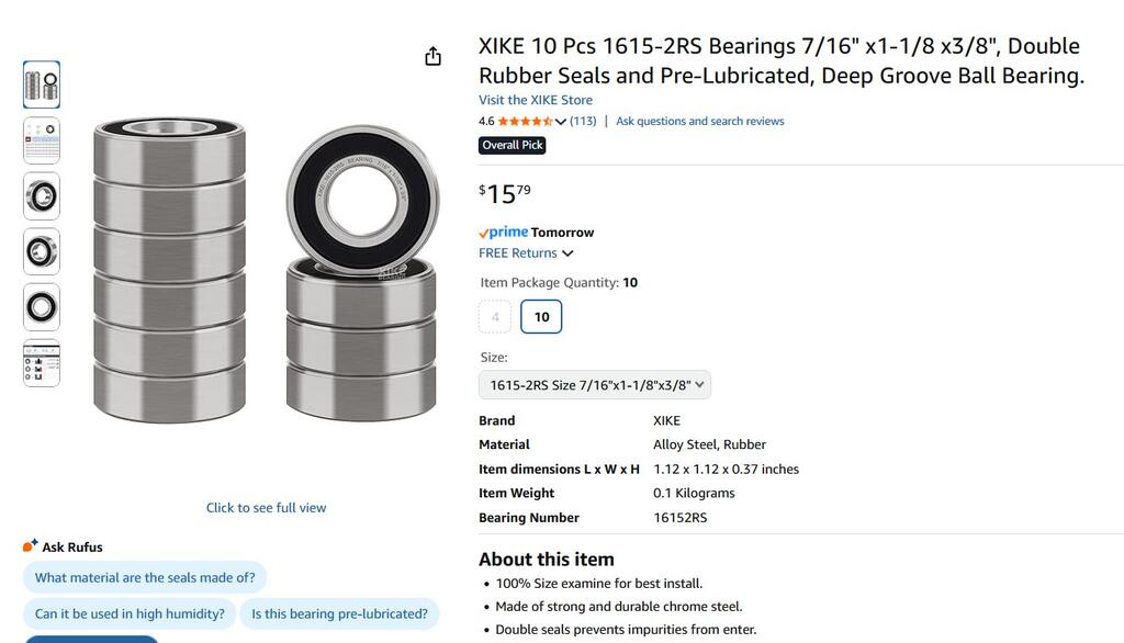

pfrederi
Bearings are 1615-2RS
WH# 6593 ..
If you buy Cheap beings like these I wold repack then with some better grease
