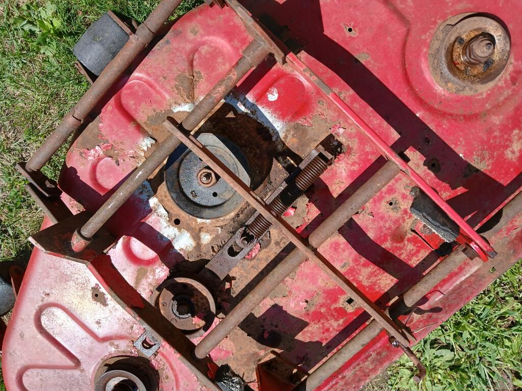

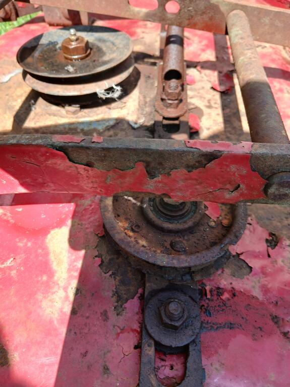

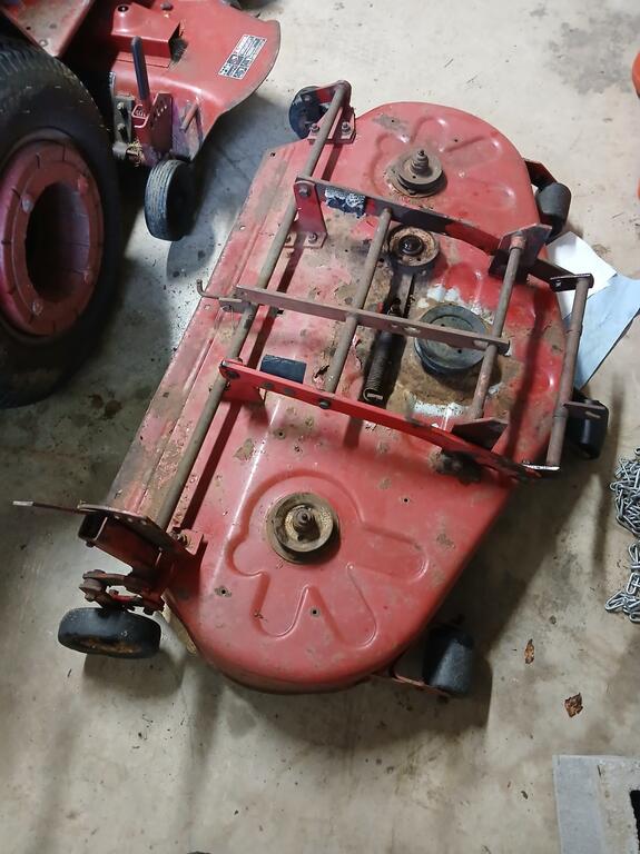

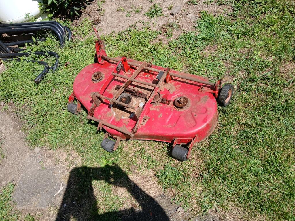

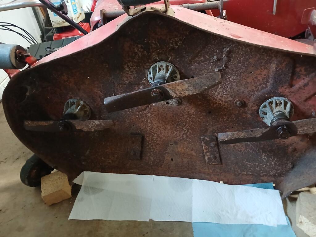

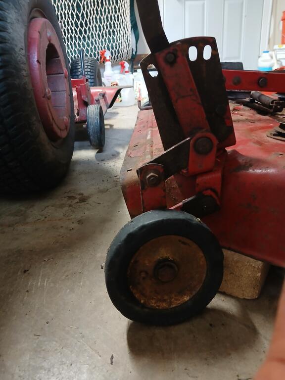

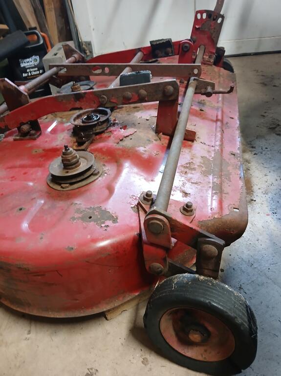

I have acquired a 42" rear discharge deck that needs some TLC. There are no labels/identification to be found. Clearly some work needs to be done to return this deck to working order. Any information you can glean from the photos would be very much appreciated.

This may help your research if for a tractor with horizontal engine crankshaft.
Mower DNA 42" rear discharge
1976 model 65-42MR01 replaced by - (Has the flat spindle belt idler pulley mounted on a triangular plate.) - (Has multi-link hardware at the gauge wheel support)
1977 model 75-42MR01 - Both use blades with 5/8" x 3/4" double-D center hole unless the spindles have been upgraded. (Has the flat spindle belt idler pulley mounted on a triangular plate) - (Has multi-link hardware at the gauge wheel support)
These all use blades with 3/4" center hole.
1977 model 75-42MR02 replaced by - (Has the flat spindle belt idler pulley mounted on a flat bar) (Has multi-link hardware at the gauge wheel support)
1978 model 85-42MR01 - (Has the flat spindle belt idler pulley mounted on a flat bar) (Has multi-link hardware at the gauge wheel support)
1979 model 95-42MR01 - Shares an illustrated parts list with 85-42MR01 - (Has the flat spindle belt idler pulley mounted on a flat bar) (Has multi-link hardware at the gauge wheel support)
1979 model 95-42MR02 - (Has no multi-link hardware at the gauge wheel support)
1980-1983 model 05-42MR01
1984 model 05-42MR02 - Last year for bearings with 3/4" ID
1985 model 05-42MR03 - First year for bearings with 17mm ID unless older spindles were updated.
1986-1988 model 05-42MR04
1989-1990 model 15-42RC01
1990-1992 model 15-42RC02
1993-2012 model 78350
Note - 17mm is .669"
