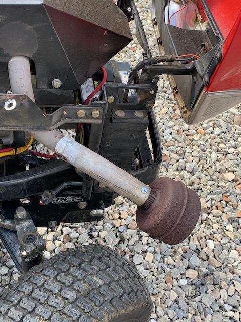

If yours is just loud this might be an option a friend calmed his down. he added a piece of conduit and a sprinkler head muffler. (wasn't going for looks)
I know some that used this muffler, they tell me it is a little a little larger in diameter and you have to adapt the outlet pipe and kind of jury rig the heat sheild.
