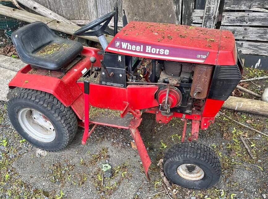

eo1bart 40 #1 Posted August 22, 2025 (edited) Hi, I'm looking for some 8" rims for my newly refurbished 312-8. I'll be mounting 16x6.5-8 tires on them. Has anyone tried these rims from surplus center? https://www.surpluscenter.com/Wheels/Spindles-Wheel-Hubs-Bearings/Wheel-Rims/8-x5-5-Steel-Wheel-Rim-3-4-Bore-w-Bearings-1-5079.axd Edited August 22, 2025 by eo1bart spelling 1 1 Share this post Link to post Share on other sites

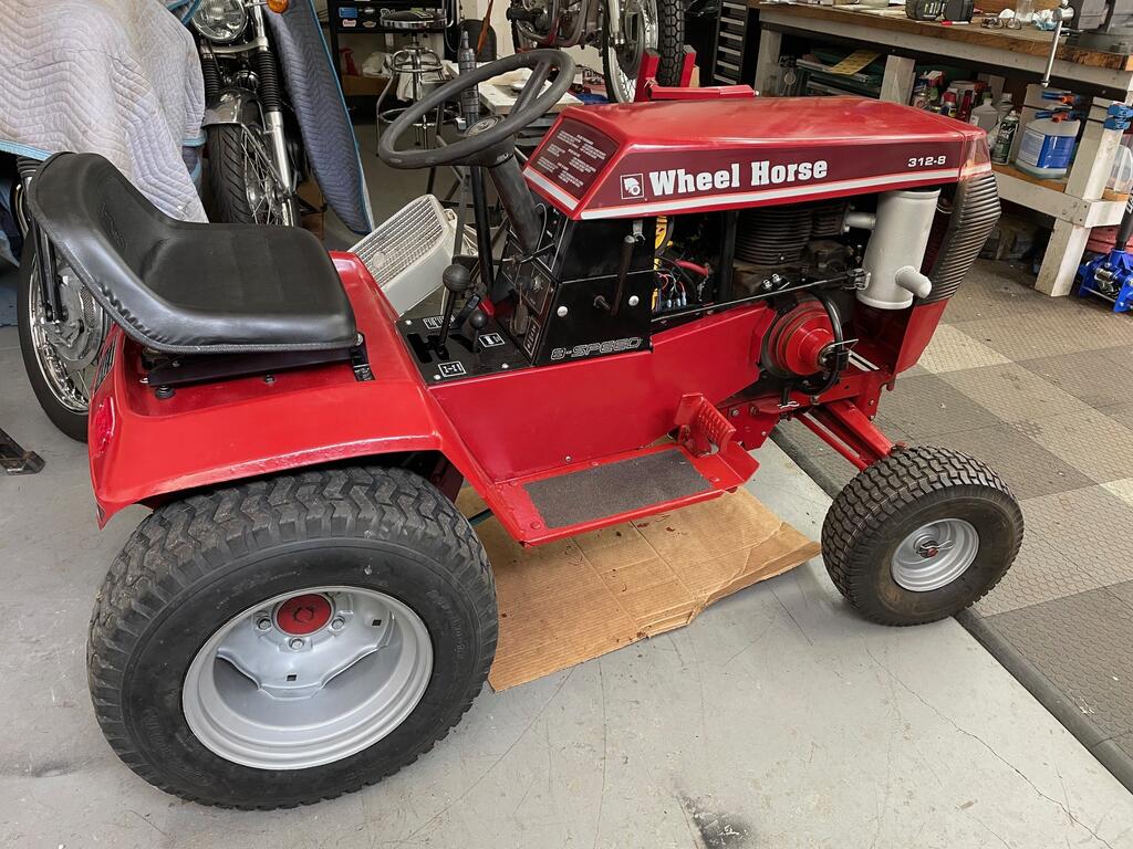

Lee1977 7,499 #7 Posted August 22, 2025 I bought 2 of them, the hug is 3" so I used a 3/4" collar and a couple of washers behind the wheel. I didn't change the spindles..They also don't have grease fittings. I have on my Raider. Kind of a pain to drill for the fittings, ground a spot first with a Dremel before drilling. They come with tube spacer between the bearings, have to knock it to the side to knock the gearings out. I had to put the grease fitting on the back side of those wheels. I used the narrow rims from the Raider with 400x8 Triribs on my 312-8. Picture of the 312-8. Picture of the Raider 12 with those wheels. Good strong wheels only problem is no grease fittings. 1 2 Share this post Link to post Share on other sites
ri702bill 10,965 #8 Posted August 22, 2025 10 minutes ago, Lee1977 said: I bought 2 of them, the hug is 3" so I used a 3/4" collar and a couple of washers behind the wheel. I didn't change the spindles..They also don't have grease fittings. I have on my Raider. Kind of a pain to drill for the fittings, ground a spot first with a Dremel before drilling. They come with tube spacer between the bearings, have to knock it to the side to knock the gearings out. I had to put the grease fitting on the back side of those wheels. I used the narrow rims from the Raider with 400x8 Triribs on my 312-8. Picture of the 312-8. Picture of the Raider 12 with those wheels. Good strong wheels only problem is no grease fittings. But, if those are sealed bearings, no fitting is needed..... Makes for cleaner wheels too. 2 1 Share this post Link to post Share on other sites

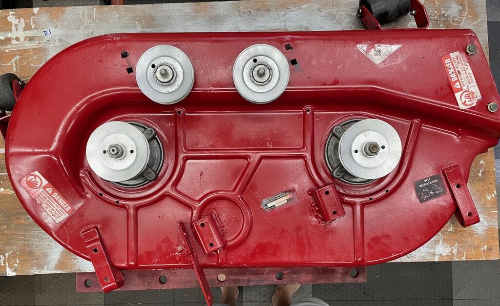

peter lena 9,642 #18 Posted August 23, 2025 @eo1bart those 37 " decks are noted for issues , mainly rotational , see all the related idler pulleys , with tiny sealed bearings ? guess what failure area is ? had one as part of a vacuum lift set up , that I sold , personally would change that set up over to a R/D 36 " deck , same hook up , but much more reliable / pete Share this post Link to post Share on other sites

eo1bart 40 #22 Posted August 24, 2025 21 hours ago, peter lena said: @eo1bart those 37 " decks are noted for issues , mainly rotational , see all the related idler pulleys , with tiny sealed bearings ? guess what failure area is ? had one as part of a vacuum lift set up , that I sold , personally would change that set up over to a R/D 36 " deck , same hook up , but much more reliable / pete Pete, I'm currently rebuilding the deck, and have already replaced all the bearings. I did not see any cracks in the deck either, which from what I understand is common at the cradle mounts on these decks. Also this mower will not get much use. I bought the tractor mainly for snow plowing, and pulling a wagon and leaf sweeper. 2 Share this post Link to post Share on other sites
