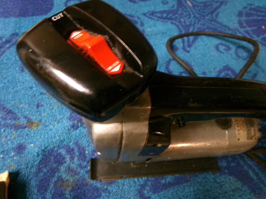

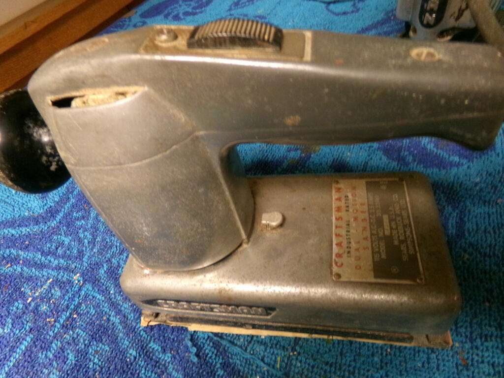

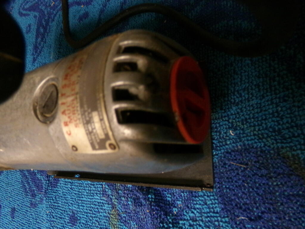

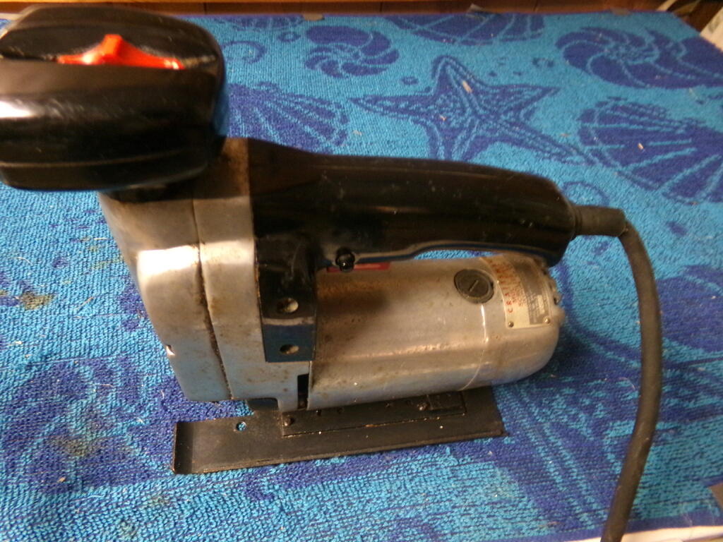

Ed Kennell 45,524 #1 Posted August 20, 2025 My el cheapo HF sander took a crap while sanding all those park bench boards. So, I spotted this one at the auction this morning. Plugged it in and it ran nice and quiet so I thought I might buy it if the price was right. When they put it up, they sold it with this scroll saw that I did not need. Both are USA made Craftsman Sears Roebuck/ Simpson MFG all metal 2.25 Amp. The sander even has an oiler port. The Scroller Saw is 1/2HP with variable speed and rotatable blade. These things are heavy at 8 and 10 lbs each. Oh, and the price was right at $2.00 + 12 cents tax for the pair. 3 11 1 Share this post Link to post Share on other sites

JoeM 9,710 #3 Posted August 20, 2025 I have the same scroll saw, it was my Dad's. The cord is all taped up where he cut into it. I don't use it because the lock on top only locks in one direction. It is/was a very actuate saw. Top quality. Got me thinking, not sure where I put. it? Share this post Link to post Share on other sites
ri702bill 11,617 #4 Posted August 20, 2025 (edited) Check the condition of the brushes on the sander - they live in a very dusty environment.. The sander must be about 60+ years old.... the cord may be about done for.... Edited August 20, 2025 by ri702bill 1 1 Share this post Link to post Share on other sites
Ed Kennell 45,524 #5 Posted August 20, 2025 2 hours ago, JoeM said: the lock on top only locks in one direction. This one locks in 4 positions at 90 degrees. 1 Share this post Link to post Share on other sites

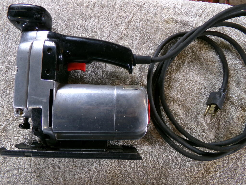

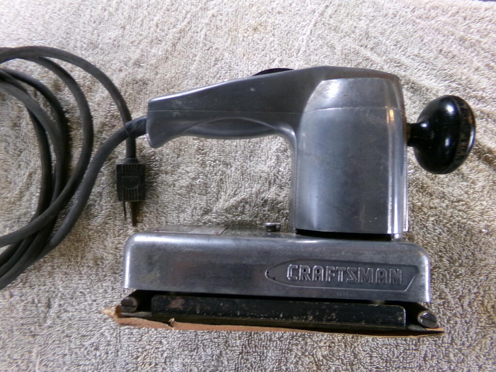

Bill D 2,693 #6 Posted August 20, 2025 (edited) Plan on changing the cord. When you do, install a three wire cord and ground the metal case. There is probably a screw inside the handle that can be used for this. Also, plug tools like that into a GFCI outlet when using. I had an old metal drill 30 years ago that I was nearly electrocuted by. I am somewhat leary of old electric tools for that reason, though I appreciate the quality compared to modern tools. Edited August 21, 2025 by Bill D 3 Share this post Link to post Share on other sites
Ed Kennell 45,524 #7 Posted August 21, 2025 20 hours ago, ri702bill said: Check the condition of the brushes on the sander - they live in a very dusty environment.. The sander must be about 60+ years old.... the cord may be about done for.... I opened them both today and checked the brushes and the cords. The sander did need a cleaning, but the brushes and cords all look good. 17 hours ago, Bill D said: Plan on changing the cord. When you do, install a three wire cord and ground the metal case. The existing 3 wire cords and grounds look good. 4 Share this post Link to post Share on other sites

formariz 12,358 #9 Posted August 24, 2025 Good find Ed. They will last a few more generations if used. No plastic , disposable mentalities back then. Changing the cords is the only must do with them. Use a three prong and ground the case. 3 1 Share this post Link to post Share on other sites
Ed Kennell 45,524 #10 Posted August 24, 2025 43 minutes ago, formariz said: Changing the cords I disassembled and cleaned both and surprisingly the original Craftsman 3 prong grounded cords and restraining grommets are like new.. Very pliable and no sign of cracking. 3 1 Share this post Link to post Share on other sites
