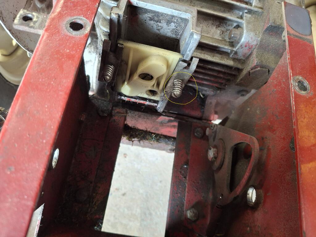

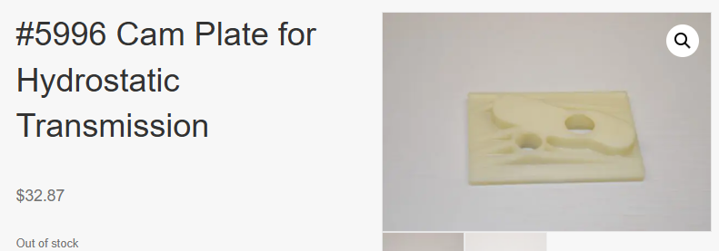

FarmallFarmer09 31 #33 Posted August 19, 2025 Okay. Now heres a question i keep forgetting about. I talked to a big guy in wheel horse at a show, because my fwd and reverse lever is super loose. It doesn't stay in one area, It will always go straight to full. Whats the plastic plate called so i can get an new one? Anyone know? (Its a 1971 Charger 12 if that helps) Share this post Link to post Share on other sites
Bar Nuthin 3,243 #34 Posted August 19, 2025 (edited) 10 hours ago, FarmallFarmer09 said: Okay. Now heres a question i keep forgetting about. I talked to a big guy in wheel horse at a show, because my fwd and reverse lever is super loose. It doesn't stay in one area, It will always go straight to full. Whats the plastic plate called so i can get an new one? Anyone know? (Its a 1971 Charger 12 if that helps) Are you talking about this piece (cam plate)? I got mine from Lowell (wheelhorsepartsandmore) but it looks like he is out of stock. BTW, that is the part number for my C-120, you need to look in your parts manual for the correct part number. Edited August 19, 2025 by Bar Nuthin Share this post Link to post Share on other sites
squonk 48,126 #35 Posted August 19, 2025 (edited) 10 hours ago, FarmallFarmer09 said: Okay. Now heres a question i keep forgetting about. I talked to a big guy in wheel horse at a show, because my fwd and reverse lever is super loose. It doesn't stay in one area, It will always go straight to full. Whats the plastic plate called so i can get an new one? Anyone know? (Its a 1971 Charger 12 if that helps) The plastic plate may not the problem. These screws may not be tight enough or the tension plates are warped /worn. I've had luck replacing the screws with allen head screws and adding a washer to increase spring pressure. Edited August 19, 2025 by squonk Share this post Link to post Share on other sites
Bar Nuthin 3,243 #36 Posted August 19, 2025 46 minutes ago, squonk said: The plastic plate may not the problem. These screws may not be tight enough or the tension plates are warped /worn. And you definitely do not want to lubricate the plate. Keep it clean. Share this post Link to post Share on other sites

FarmallFarmer09 31 #38 Posted August 19, 2025 9 hours ago, squonk said: The plastic plate may not the problem. These screws may not be tight enough or the tension plates are warped /worn. I've had luck replacing the screws with allen head screws and adding a washer to increase spring pressure. Okay ill take a look at it. Share this post Link to post Share on other sites

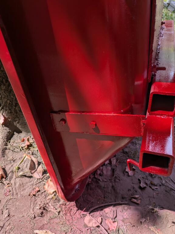

FarmallFarmer09 31 #41 Posted September 21, 2025 Hey what oil does the Charger 12 take in the rear end, (Hydrostatic) As well as the filter? filter is rusted over, Cant see numbers anymore. Regal red works well! Did a dump cart before the tractor so i could test colors. Looks great, Sandblasted and bondo for dents. 1 Share this post Link to post Share on other sites
