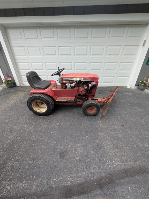

FarmallFarmer09 19 #1 Posted August 17, 2025 Im going to restore my wheel horse Charger 12. Or at least thinking about it. I heard that Rust-Oleum IH red is a budget friendly close color to Wh original red. But what about the engine? i got to thinking, Doesent the engine get hot? What do i do about that? I found red caliper paint, But i dont think its going to be the same as the ih red. Wheres a good place to get decals? I was looking at "Restore your horse" At the decals , but they are incredibly expensive. Any tips? Share this post Link to post Share on other sites

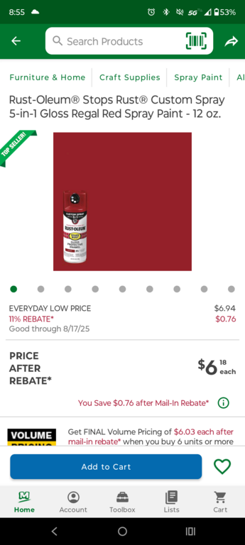

rmaynard 16,992 #2 Posted August 17, 2025 Rust-Oleum Regal Red seems to be the choice of many Wheel Horse owners. As far as the engine, the only area that gets hot enough to discolor the paint is around the exhaust. Decals from redoyourhorse.com (our vendor Vinylguy), may be a little pricy, but they are good, and as far as I know, they may be your only source for some one of a kind decals like dash panels and engine spec plates. 10 Share this post Link to post Share on other sites
ri702bill 11,545 #3 Posted August 17, 2025 2 minutes ago, rmaynard said: Rust-Oleum Regal Red seems to be the choice of many Wheel Horse owners. As far as the engine, the only area that gets hot enough to discolor the paint is around the exhaust. Decals from redoyourhorse.com (our vendor Vinylguy), may be a little pricy, but they are good, and as far as I know, they may be your only source for some one of a kind decals like dash panels and engine spec plates. Ya gets what ya paid for...... Rustoleum is a good "backyard" type of product - but - you need to wait about a month in order to apply the decals. It has a very slow cure time. Some folks buy the paint in quarts, mixing it with a hardening catalyst. That is best applied with a HVLP spraygun. Having bought several times from Vinylguy, I was never diaappointed.... 4 1 Share this post Link to post Share on other sites
Brockport Bill 2,254 #4 Posted August 17, 2025 i use the 600 degree spray paint from auto stores on anything engine related 1 Share this post Link to post Share on other sites
squonk 45,814 #5 Posted August 17, 2025 (edited) I spray just about everything with Rusty Regal Red. I have never sprayed it through a gun. My gun jobs have all been "Automotive paint. sometimes a single stage enamel and sometimes a basecoat/clearcoat mix. On the rattle can spray jobs, when I spray my last coat of color, I grab a can of rusty Chrystal Clear and immediately spray a coat of clear on the color. Then wait about 15 min then another coat of clear. Cuts the drying time by a ton. I spray engines the same way and they hold up well. The heads I use Duplicolor engine paint with a coat of clear the same way. As far as color goes, everyone sees red differently. some folks like Rusty Sunrise Red. But to me that looks too orangey especially under lights. Buy a can of each and spray a chunk of metal from something scrap and look at it under natural sunlight then decide what you like. Edited August 17, 2025 by squonk 3 Share this post Link to post Share on other sites

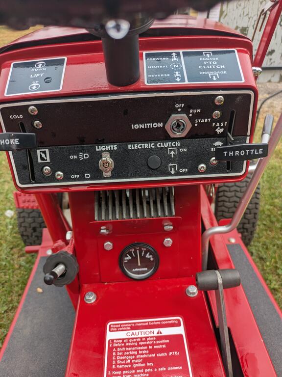

FarmallFarmer09 19 #15 Posted August 18, 2025 (edited) 2 hours ago, TonyToro Jr. said: Are you talking about the plastic piece behind the dash area? If so I have one. Pm me. this is off of a restored tractor same model as mine. Just in better shape than mine is Edited August 18, 2025 by FarmallFarmer09 Share this post Link to post Share on other sites

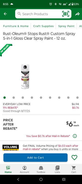

FarmallFarmer09 19 #16 Posted August 18, 2025 And after i paint it, Should i clear coat it? And if i do clear coat it, What do i use? I plan on using good old rattle can paint job, And im getting all my paint from menards. 1 Share this post Link to post Share on other sites
FarmallFarmer09 19 #17 Posted August 18, 2025 2 hours ago, AlexR said: I used Rust-Oleum cottage white I believe there is a linen white people use as well. I think i may use white. Most images of the model wheel horse i have all have white rims 1 Share this post Link to post Share on other sites
AlexR 2,712 #18 Posted August 18, 2025 5 minutes ago, FarmallFarmer09 said: And after i paint it, Should i clear coat it? And if i do clear coat it, What do i use? I plan on using good old rattle can paint job, And im getting all my paint from menards. I got my paint from Menards as well and this is what I got. I have heard the best practice to spray clear on is right after the last color coat to spray the clear on and wait 15 min and spray another clear. Share this post Link to post Share on other sites

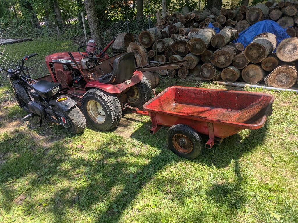

FarmallFarmer09 19 #19 Posted August 18, 2025 17 minutes ago, AlexR said: I got my paint from Menards as well and this is what I got. I have heard the best practice to spray clear on is right after the last color coat to spray the clear on and wait 15 min and spray another clear. Perfect. Now, How many cans will cover the whole machine, A dozer blade, and a dump cart? I Was thinking 4 but Im not sure... Share this post Link to post Share on other sites
TonyToro Jr. 2,392 #20 Posted August 18, 2025 Your gonna need a few more then 4. It would probably be 4 just for the dozer blade and cart. 1 Share this post Link to post Share on other sites
FarmallFarmer09 19 #21 Posted August 18, 2025 1 minute ago, TonyToro Jr. said: Your gonna need a few more then 4. It would probably be 4 just for the dozer blade and cart. So how much would the tractor itself be. Maybe I can skip the blade or something. Share this post Link to post Share on other sites
TonyToro Jr. 2,392 #22 Posted August 18, 2025 I would say probably 5 depending on how many coats you do Share this post Link to post Share on other sites
