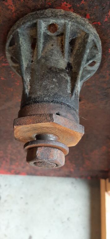

John c 135 #1 Posted August 13, 2025 (edited) Anybody familiar with this style blade hub > It looks like it has/is splined to the spindle shaft. Any pointers on removing it, my first thoughts would be a 3 jaw puller some heat and penetrating oil Edited August 13, 2025 by John c spelling Share this post Link to post Share on other sites
nylyon-(Admin) 8,742 #2 Posted August 13, 2025 That is all one piece, and is removed by removing the pulley from the top. Once the pully is removed the entire shaft (the large hex on down) comes out of the bearings pretty easily. Tough part, usually, is getting the pulley off on the top. If it’s the ¾” shaft, those are keyed and come out pretty easily, the metric ones can be very difficult. Share this post Link to post Share on other sites
John c 135 #3 Posted August 13, 2025 Thank you Karl........The pulleys are 3/4" with the keyway and in pretty bad shape where the belt held moisture on them. Share this post Link to post Share on other sites
nylyon-(Admin) 8,742 #4 Posted August 13, 2025 Pop the pulley off, careful not to bend the pulley. Once that is off a very light tap and that shaft will slide out of the bearings. On the bottom side there is a spring clip, you can remove that, bang our the bottom bearing, then the top can be banged out as well. Share this post Link to post Share on other sites

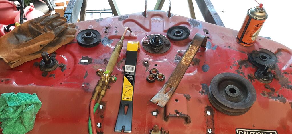

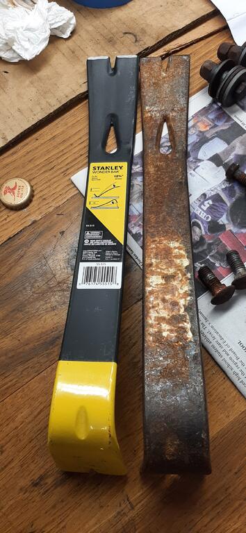

peter lena 9,716 #5 Posted August 13, 2025 @JOHN C. thats easy , get 2 wonder bars ,slide one , with curved bottom edge , right on top of deck to spindle bolt ,and another one just opposed same way penetrating oil , push bars away from each other , lift right off . the snug fit of the bar right up against the center of the spindle , gives you a perfect easy leverage point . no pulley damage at all . if you are doing the bearings , and you should , use lucas x tra hd green chassis grease , clean out original grease , even in new bearings , walmart 5$ extreme temp 550 flash point , polyurea rated , done all my decks , no bearing whine , also do the related mule drive bearings . that way all rotational deck bearings are done , you can also do the pto cone bearings inner needle , minimum grease , outer sealed bearing , napa . get back to on a added pulley for the back of deck belt , take the bounce out of it , give me a shout , I know where you are , decks are cake . pete , Share this post Link to post Share on other sites

peter lena 9,716 #7 Posted August 14, 2025 @John c perfect lift off pulley picture , 2 wonder bars , short curled end , will just slide on bolt top under pulley , also make sure bar end is tight up against the pulley hub ? strongest part of pulley , and solid leverage advantage . done this a number of times . another thing I do is to detail function , do a grease , change out , eliminate bearing whine , also add a 3" flat idler pulley , on the back side of the spindle pulley belt ? long unsupported belt bounce , helps bearing failure , belt push back , once I started gaining gaining on details , just kept going . 1 Share this post Link to post Share on other sites

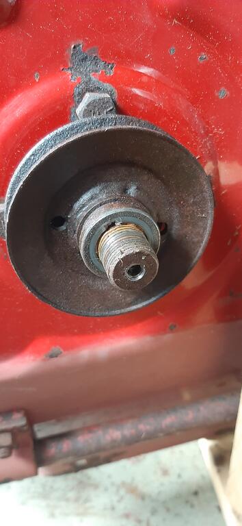

John c 135 #14 Posted August 15, 2025 Pete that 2 pry bar trick is the way to go to get pulleys off.. I wasn't expecting this 2nd piece on the back side of the driven pulley, it was keyed, but the pulley wasn't, but it looked like maybe at some point it was, the inside of the bore showed signs of having been touched up. All three spindle shafts and clean and smooth at the pulley. I'll take the spindles off and apart over the weekend Not much different after all these years 1 Share this post Link to post Share on other sites

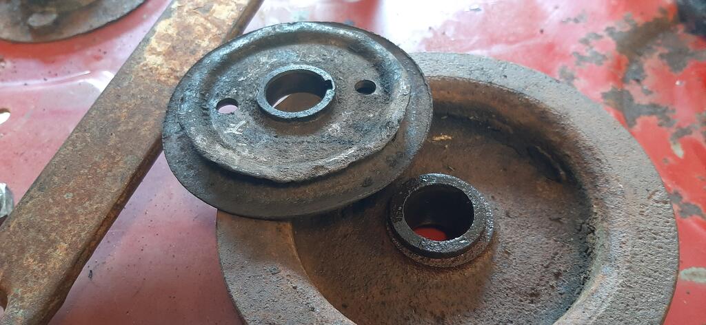

John c 135 #16 Posted August 20, 2025 (edited) The drive pulley on this deck is in 2 pieces, and I can't figure out why. Has something broken off or missing. Any of you guys have any experience with a pulley such as this ? Thanks Edited August 21, 2025 by John c Share this post Link to post Share on other sites
