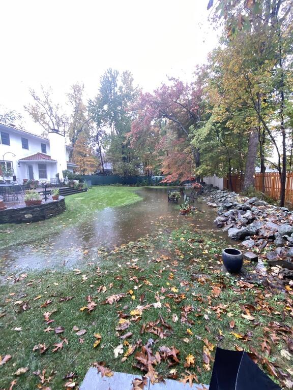

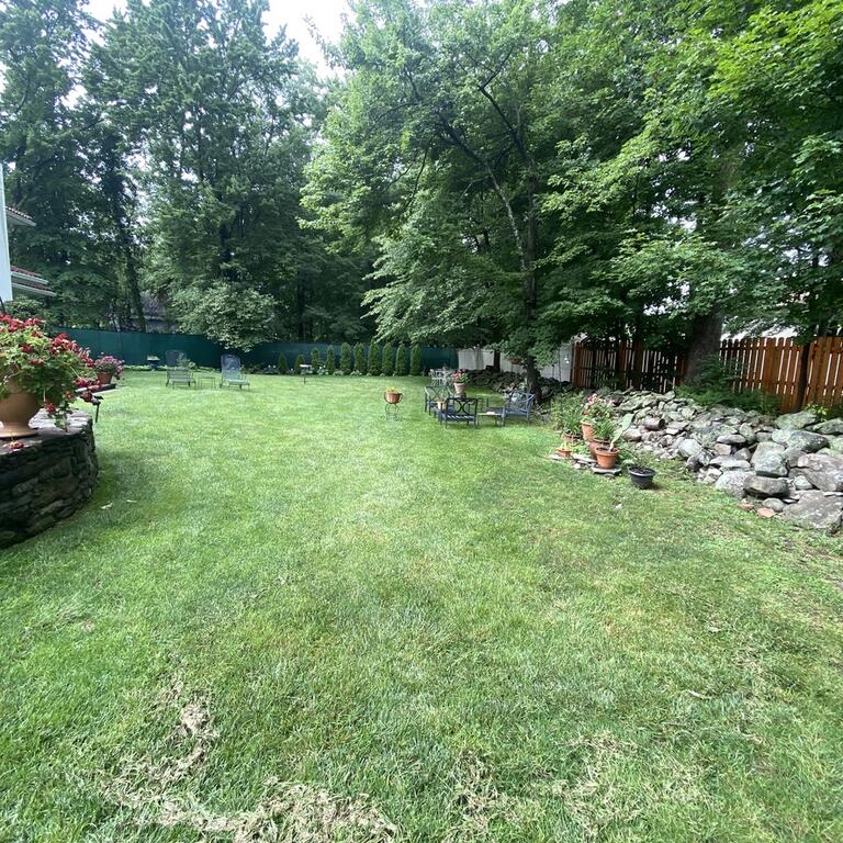

Thanks Very Much,   for the replies.  Sorry, Omitted the driveway is asphalt coated.  Yeah, a French drain would help but BIg Big $18K.    The Town has rules where it can only drain into a County Storm Drain.   So it's 500 feet + Permit, Blueprints and Plans & County approved Contractor.  So i'M better off getting a Tractor. Tony Nice Video on the snow,   I get the same heavy packing type in the Hudson Valley.   The yard, when wet and dry but its always kinda wet.... Thats why the interest in the posi rear.... I put 2 buckets on the back of the Cub, which are 100#'s each.
