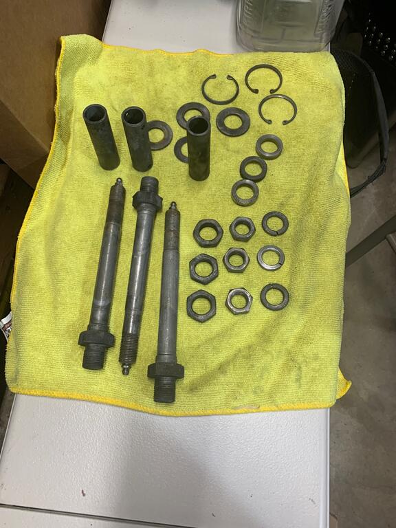

You should be able to get the remainder of the zerk fitting out of the spindle shaft with a small easy out. I've done that a couple times and no issues replacing. The spindles are pretty easy to rebuild and bearings are readily available on Amazon. Just have to remember to remove the dust cover that is going to face inside the spindle.

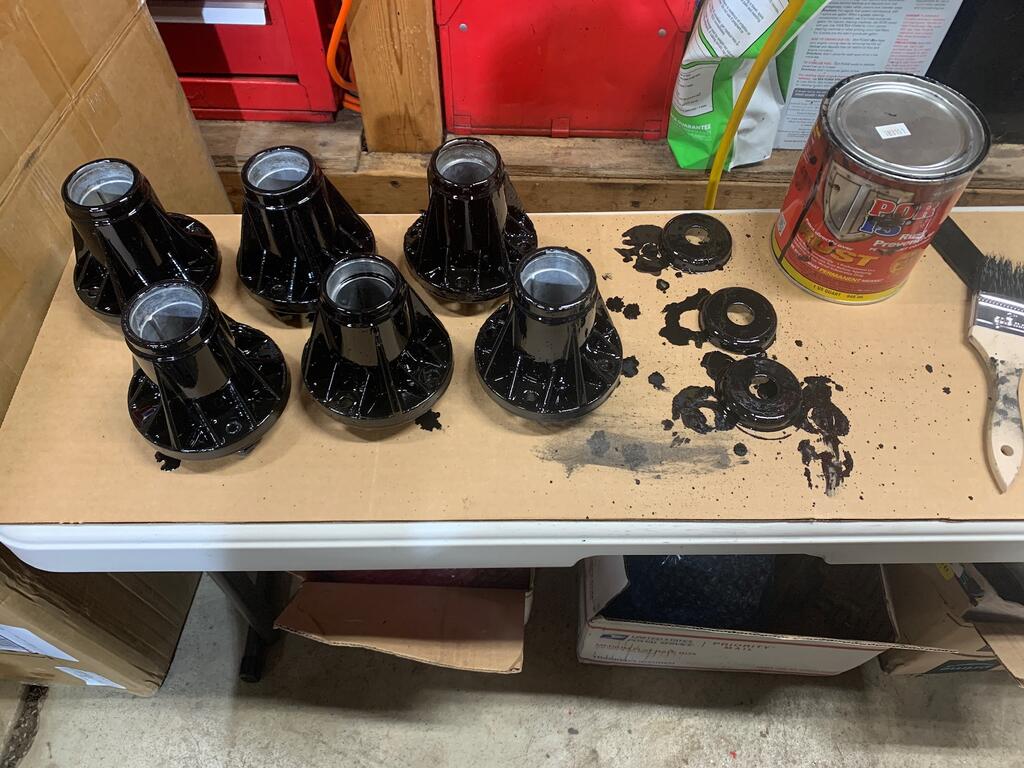

I usually paint the spindle housing with Por 15 or something similar since the housing is most susceptible to corrosion from the grass clippings.

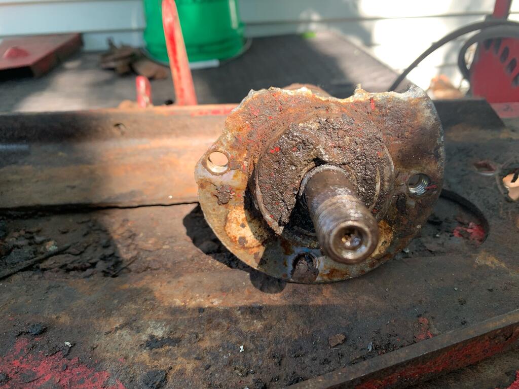

If they're corroded so badly that they are missing attachment points, this set from 8-Ten will work except you will need to use the original deck pulleys.

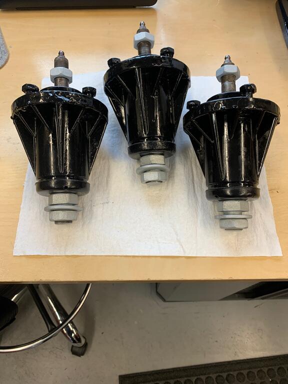

This thread is my 42" deck rebuild and if you read through it you will see some fairly detailed pictures and explanation of the spindle rebuild.
This deck uses the same spindles as the 48".
