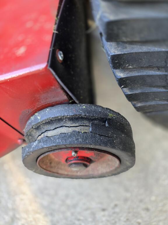

JR Pedersen 18 #1 Posted August 8 I'm trying to find a cheaper route to fixing or replacing these without having to order the $60+ online. See pic for the current state of the wheels... Share this post Link to post Share on other sites

WHX?? 52,912 #4 Posted August 8 https://wheelhorsepartsandmore.com/product/steel-deck-wheels-with-bolts-2-5303-110506/ I have no idea why these wheels are so $$. Might find them cheaper on Flea Bay. 1 Share this post Link to post Share on other sites
rjg854 12,515 #5 Posted August 8 K&B horse parts has the correct wheels for the rotary decks, I picked up a set at the Show. He's in the vendor section, give him a call. 2 Share this post Link to post Share on other sites
oliver2-44 10,978 #6 Posted August 8 If you're truly trying to go cheap, you can find wheels on Ebay or Amazon for a lot less. They won't have the grease fitting, so you get what you pay for. 1 Share this post Link to post Share on other sites
rjg854 12,515 #7 Posted August 8 You can buy cheaper ones at Tractor Supply also if that's the way you want to go 😉 1 Share this post Link to post Share on other sites
JR Pedersen 18 #8 Posted August 11 On 8/8/2025 at 5:43 PM, rjg854 said: You can buy cheaper ones at Tractor Supply also if that's the way you want to go 😉 What specs do I need to check to make sure they're the right ones? 1 Share this post Link to post Share on other sites
rjg854 12,515 #9 Posted August 11 1 hour ago, JR Pedersen said: What specs do I need to check to make sure they're the right ones? You'd want the type that has the offset hub. Meaning, the hub on one side is out flush with the edge of the tire, and then you'd still most likely have to use washers to bring the wheel out far enough it won't rub on the shell of the deck. Just get the same diameter wheel. I went that route at one time, "in a pinch" the bearings don't hold up well and there's not an easy way to keep them greased. 2 Share this post Link to post Share on other sites
peter lena 9,457 #10 Posted August 11 @ jr pedersen , the commonality of those wheels is poor design and make up , the push in bearings don,nt help . its the size of wheel type that makes for failure , bigger is better , but still requires some engineering to make it last . also that single inside mount point , does not support it well . a slide / trackless wheel will also , rotate yet slide to any side deflection , that dig in point , starts the entire failure again and again . thinking a swivel mount bolt on . pete 1 Share this post Link to post Share on other sites
JR Pedersen 18 #11 Posted August 11 5 hours ago, peter lena said: @ jr pedersen , the commonality of those wheels is poor design and make up , the push in bearings don,nt help . its the size of wheel type that makes for failure , bigger is better , but still requires some engineering to make it last . also that single inside mount point , does not support it well . a slide / trackless wheel will also , rotate yet slide to any side deflection , that dig in point , starts the entire failure again and again . thinking a swivel mount bolt on . pete Thanks Pete...it would be nice to be able to buy a larger rubber wheel that would fit over the original one... although wouldn't a larger tire cause issues if you want to adjust the deck to cut the grass lower? Share this post Link to post Share on other sites
peter lena 9,457 #12 Posted August 11 @JR Pedersen https://www.google.com/search?q=mower+deck+swivel+wheels&rlz=1C1CHBF_enUS866US866&oq=mower+deck+&gs_lcrp=EgZjaHJvbWUqDggAEEUYJxg7GIAEGIoFMg4IABBFGCcYOxiABBiKBTIGCAEQRRhAMgYIAhBFGDkyBggDEEUYPDIGCAQQRRg8MgYIBRBFGDwyBggGEEUYQTIGCAcQRRhB0gEINjY1MGowajSoAgiwAgHxBRp0KqCY026b&sourceid=chrome&ie=UTF-8 this is the site I was snoopon around on , looks like the possible ideas that you might try / think of . realise not exact type , but definitely , ideas , pete 1 Share this post Link to post Share on other sites
JR Pedersen 18 #13 Posted August 12 17 hours ago, peter lena said: @JR Pedersen https://www.google.com/search?q=mower+deck+swivel+wheels&rlz=1C1CHBF_enUS866US866&oq=mower+deck+&gs_lcrp=EgZjaHJvbWUqDggAEEUYJxg7GIAEGIoFMg4IABBFGCcYOxiABBiKBTIGCAEQRRhAMgYIAhBFGDkyBggDEEUYPDIGCAQQRRg8MgYIBRBFGDwyBggGEEUYQTIGCAcQRRhB0gEINjY1MGowajSoAgiwAgHxBRp0KqCY026b&sourceid=chrome&ie=UTF-8 this is the site I was snoopon around on , looks like the possible ideas that you might try / think of . realise not exact type , but definitely , ideas , pete I'm checking them out now through your link - Thanks. I was wondering if those swivel wheels would work... Share this post Link to post Share on other sites
peter lena 9,457 #14 Posted August 12 @JR Pedersen that was my intent , looking at selection , most important is wheel rotation start and angular slide , side area , to prevent hang ups. always looking for an improvement area , you can always paint it red , and make it disappear. when swivels work correctly , they do it with total ease , they would also mount on outer edge deck corners . glad you are on it, that axel swing point has to be greasable , to enhance swivel , when correct , its seamless . giving you the ok to experiment , pete 1 Share this post Link to post Share on other sites
