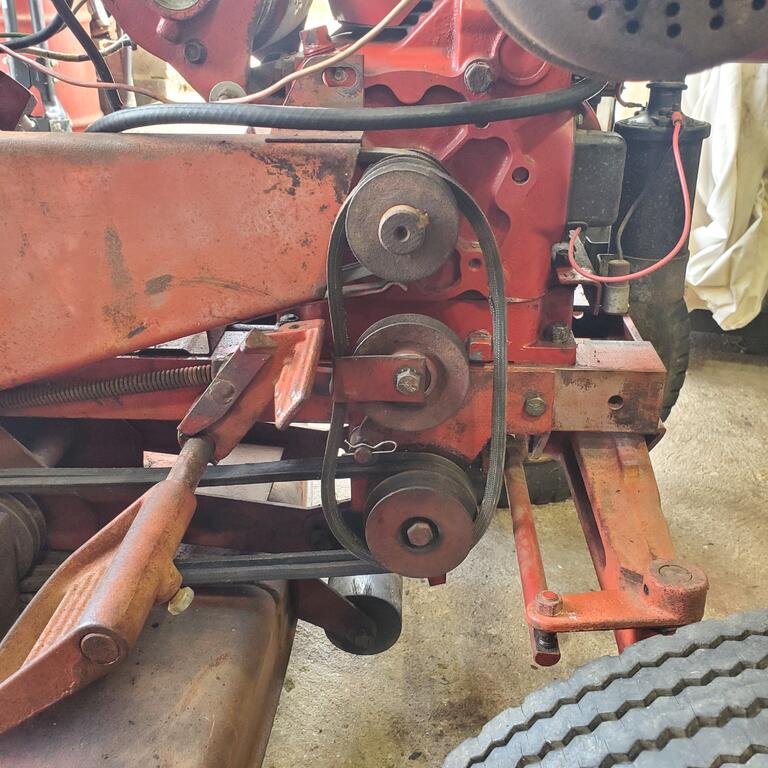

Cjwv1975 117 #1 Posted August 7, 2025 Does this look correct? Tried to follow manual but tough to see pics. Seems to function as it should. 2 Share this post Link to post Share on other sites
Achto 30,857 #2 Posted August 7, 2025 Looks correct to me. 1 Share this post Link to post Share on other sites
ri702bill 11,145 #3 Posted August 7, 2025 (edited) Looks good - but you may wish to rotate the angle on the bent idler tab. It should be touching the belt to stop it with the PTO not engaged as shown. Adjust it and check it when it is engaged that it is clear of the belt... Bill Edited August 7, 2025 by ri702bill 1 Share this post Link to post Share on other sites

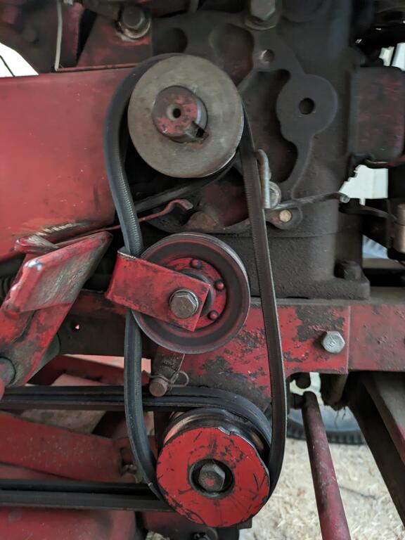

Handy Don 15,755 #4 Posted August 8, 2025 20 hours ago, ri702bill said: may wish to rotate the angle on the bent idler tab. I rotated the idler tab clockwise a bit and also added a guide on the other side fabbed from a thin rod to help lift the belt out of the engine pulley groove when the PTO is disengaged. Seems to work well. Share this post Link to post Share on other sites

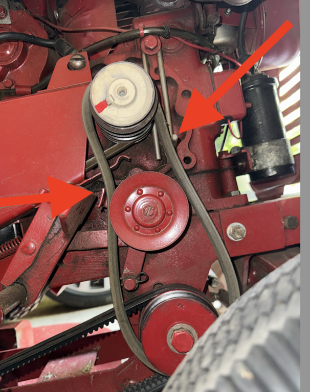

ri702bill 11,145 #5 Posted August 8, 2025 I have the stop tab mounted behind the idler, same as Don's. I find it easier to change or remove the belt that way.... Share this post Link to post Share on other sites
rjg854 12,834 #6 Posted August 8, 2025 That's the way mine is set up Share this post Link to post Share on other sites
