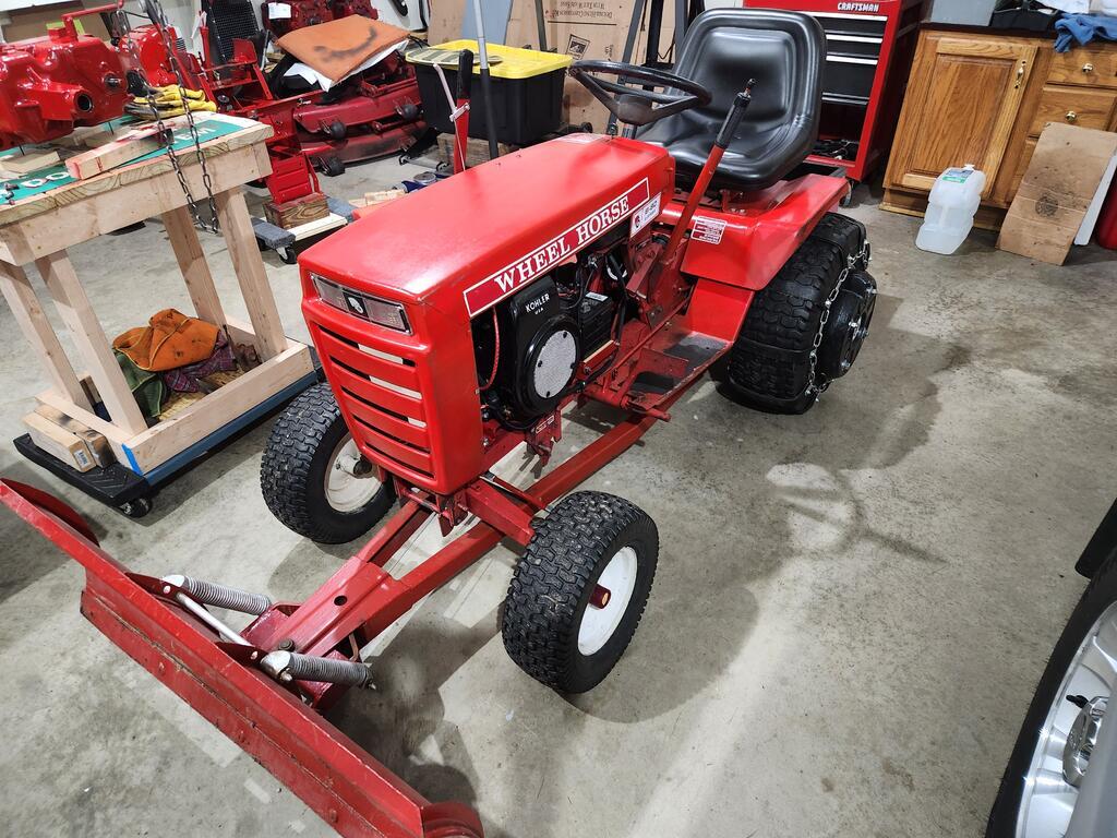

Racinbob 12,878 #3 Posted August 5, 2025 I'm very partial to the 76-77 B series. They are identical to the C series of those years other than a few minor basically cosmetic things. In 78 the B's became light duty lawn tractors. I much prefer the older style steering tower for access to things 'inside', the underhood fuel tank although the rear mount does make sense but is causes other issues and the lack of engine wobble mounts. In my opinion those two years were Wheel Horses finest. I purchased mine brand new just after the blizzard of 78. It was a leftover model sitting on the floor of Chandlers Wheel Horse in South Bend. Shortly after that I converted it to a 'B'-160 and it spent a large amount of its life that way tilling, pushing dirt gravel and gravel, blowing snow and of course, mowing. I worked the snot out of it and never heard a single complaint. Here it is with the K341. I recently converted it back to a B-80 and dedicated it to a snowblade year round. 7 Share this post Link to post Share on other sites

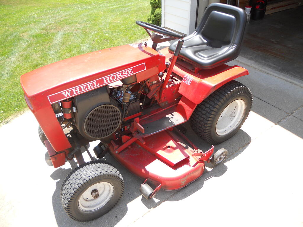

Sparky-(Admin) 24,862 #5 Posted August 5, 2025 Another guy here that’s fond of the B-80. This is my ‘77 with the 8 speed. I run a 36” RD on it a few times in the summer. and she goes to a few tractor shows. Doesn’t see winter duty though. 4 4 Share this post Link to post Share on other sites
