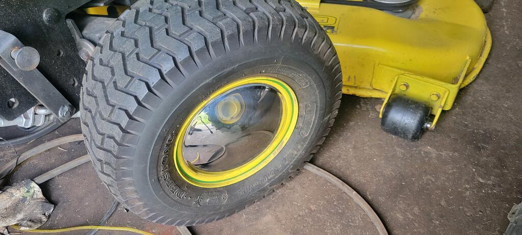

RED-Z06 2,718 #3 Posted August 3, 2025 48 minutes ago, clueless said: What the source for the 7.75"? Phoenix R2512 Tow Dolly wheel covers. 1 Share this post Link to post Share on other sites
RED-Z06 2,718 #4 Posted August 3, 2025 Thats an 18x8.50-8 on a 8" rim. Share this post Link to post Share on other sites

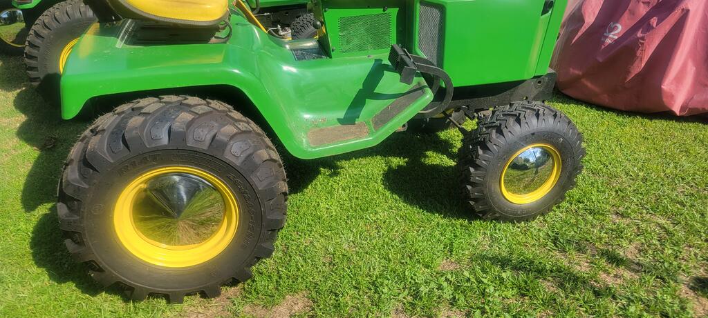

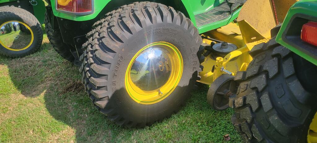

RED-Z06 2,718 #8 Posted August 14, 2025 (edited) If you go with the R1307SS 10.2" covers you will find that they just...dont quite fit inside a 12" wheel..the actual measure would need to be 10⅛..so i took my 4.5" grinder with a thin wheel and cut the lip so there were (4) 1" tabs..they slip in and only deform the roundness ever so slightly. These are all wheel steer wheels so a conventional cover wouldn't even come close to fitting..but, these do fit. This one, i grabbed a few sets of conical covers off ebay, they fit really well but the conical shape is not the "baby moon"...but, ootions are extremely limited so you do what you can...im not spending $250 on Wheelhorse logo covers or $200 on Deere logo covers...its not that big of a deal. Edited August 14, 2025 by RED-Z06 Share this post Link to post Share on other sites
