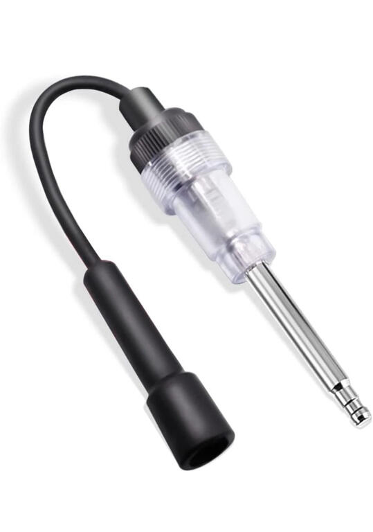

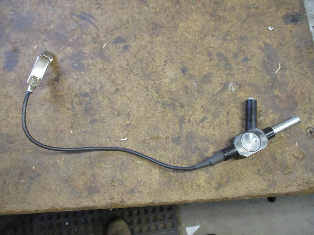

pfrederi 21,146 #51 Posted August 16, 2025 (edited) How have you tested for spark? Neon tester or a jump the gap type? Get a new H-10 ( or better get an NGK B-6L) plug put a jumper wire battery to + Coil terminal and crank (leave condenser off) Edited August 16, 2025 by pfrederi 1 Share this post Link to post Share on other sites
Krice58 181 #52 Posted August 16, 2025 I just used one of the inline see through spark tester with the little light, I’m assuming that’s the neon style. I’ll have to try jumping the wire when I get home later. It did have spark when I first started working on it, but ever since I redid the wiring, I’ve got nothing. Checked all the pto switch connections, brake switch, it’s getting power to coil and solenoid. It’ll crank all day, but no spark. I replaced points and condenser, set points to .020. Share this post Link to post Share on other sites

pfrederi 21,146 #55 Posted August 16, 2025 Those testers will frequently flash but there is no spark at the plug. Has happened to me several times Some plugs will fail under compression...(Champion I am talking about you !!) Get a new plug. These tester (B&S) are more reliable Share this post Link to post Share on other sites
