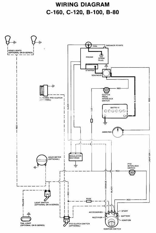

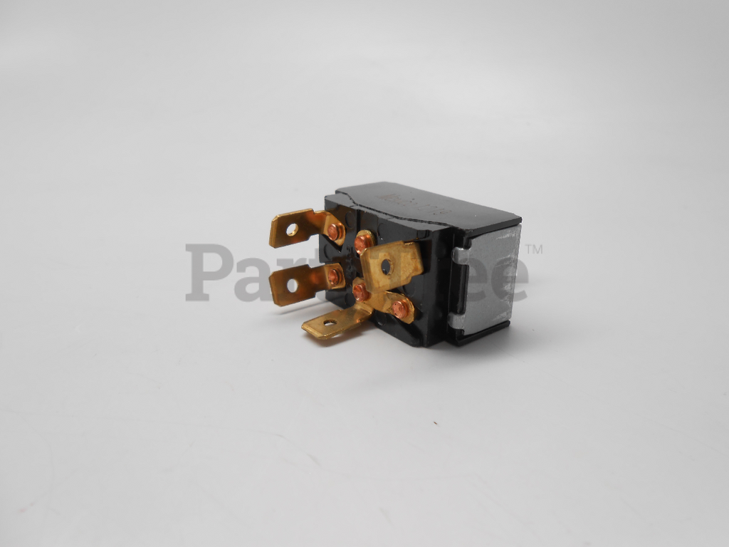

Krice58 181 #30 Posted August 6, 2025 Starting wiring using a few diagrams I found, and I’m just a bit confused. Everything is pretty straight forward except for the pto safety switch and seat switch. The pto switch is four terminal, but had like six wires going to it. I’m trying to figure out which pin corresponds to what as I don’t see any markings. Share this post Link to post Share on other sites

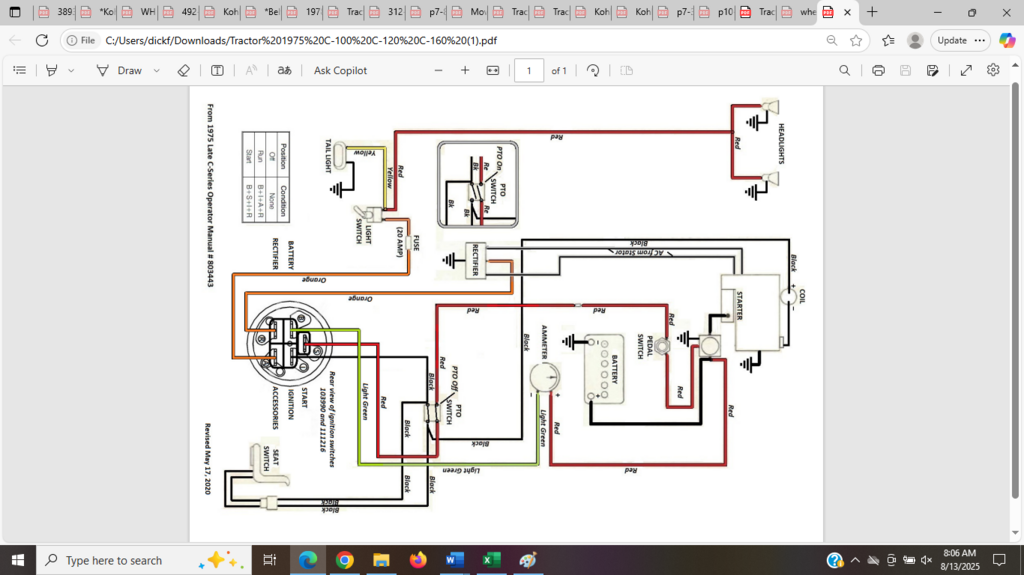

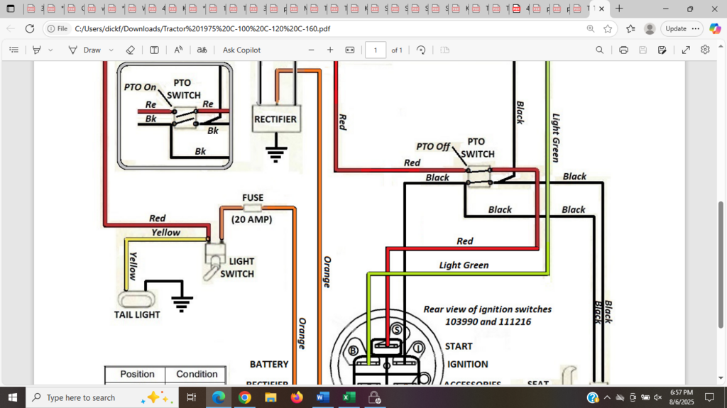

953 nut 69,256 #31 Posted August 6, 2025 The 1975 drawing should help clarify the PTO wiring. It has two drawings of the PTO switch, one with it ON and one with it OFF. Both halves of the PTO switch are normally open (NO). With the PTO in the OFF position the lever will apply pressure to the switch closing both pairs of contacts. With the PTO in the OFF position power will go to the ignition coil with the ignition switch in the run position. Also, power will go to the starter solenoid (via the brake switch) when the ignition switch is in the start position. With the PTO in the ON position both switches will open preventing the starter from operating and interupting the power to the ignition coil unless the seat switch is depressed. With a driver in the seat the ignition will continue to operate with the PTO on. Using an ohm meter you will find that two pairs of the PTO switch terminals will show continuity with the switch activated (pressure applied) and both of these pairs will have no continuity when pressure is released from the switch. It is not important which function is on a particular pair of terminals. The seat switch is also a NO (normally Open) switch and will be close when a driver is in the seat. 2 Share this post Link to post Share on other sites

gwest_ca-(File Mod) 12,487 #36 Posted August 13, 2025 There is a photo of the switch connector and the wires in this file. Wire colors may not match as this switch was used for multiple years. Click on the picture Share this post Link to post Share on other sites

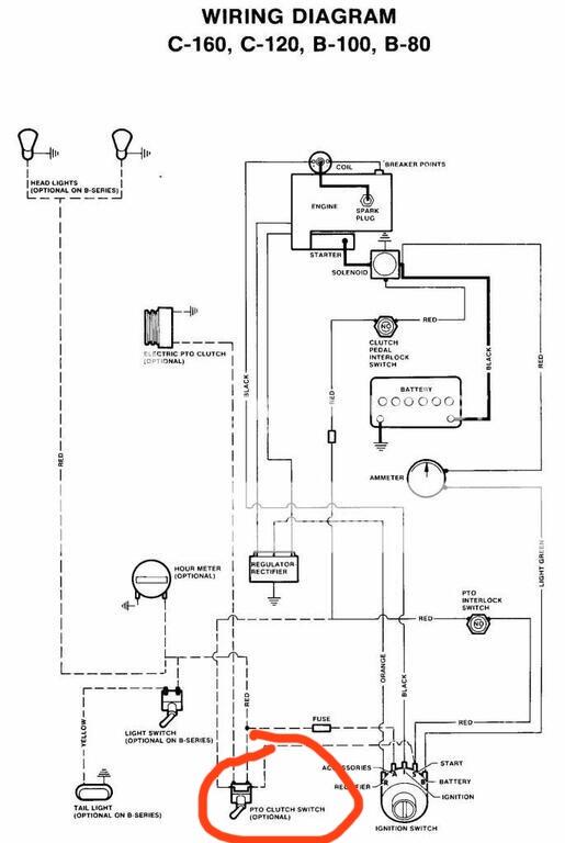

gwest_ca-(File Mod) 12,487 #37 Posted August 13, 2025 On 8/7/2025 at 2:02 PM, Krice58 said: Anyone one have a part # for the toggle switch on the dash for the electric pto clutch? Looks like a 4 terminal, but there was an aftermarket two terminal on mine that is rusted away. May be this switch but do you need it? It also controlled the starter like the manual pto switch. You can not use both. Click on the picture for more. Share this post Link to post Share on other sites
Krice58 181 #38 Posted August 13, 2025 1 minute ago, gwest_ca said: May be this switch but do you need it? It also controlled the starter like the manual pto switch. You can not use both. Click on the picture for more. I don’t actually think it was originally equipped with this switch. I think it was just an extra accessory switch someone put in the dash because it does not have an electric pto clutch. I took that one out completely. Just have the ignition switch and light switch. Share this post Link to post Share on other sites
gwest_ca-(File Mod) 12,487 #39 Posted August 13, 2025 OK I see now. There was a kit back in the day to install an electric clutch listed for this model of tractor. Kit number 8-3513 or 83513. Share this post Link to post Share on other sites
953 nut 69,256 #40 Posted August 13, 2025 11 hours ago, Krice58 said: Every time the key switch is in the on position the engine will crank if the pto is off, if I engage the pto it cranks normally, but it doesn’t want to fire either way. It did start briefly, so I believe that’s just a dirty carb issue, once we get your wiring problem out of the way we can work on the fuel system. which I expected. I’m lost, I apologize, wiring isn’t my strong suit. No need to apologize, most people are electrically challenged. Your PTO switch has two parts (two switches in one housing) and we just need to get the wires on the correct terminals so it will do its job. Six wires are attached to the PTO switch. I won’t go into too much theory on how the switches interact, just get your wires hooked up so you can get things working properly. Two of those wires come from your seat switch, both are black and they need to be separated from one another. There is also a black wire coming from your ignition switch “I” terminal and a black wire going to your ignition coil + terminal. One wire from the seat switch will be paired with the wire coming from the ignition switch and the other wire from the seat switch will be paired with the wire going to the ignition coil. Once these two pairs of wires have been joined we will consider each pair to be one black wire pair. There are two RED wires going to the PTO switch. One red wire comes from the ignition switch S terminal and the other goes to the brake/clutch switch and on down to the solenoid. With the switch sitting on the table and no force applied use a multimeter to check for continuity between the four terminals, there should be no continuity. Now push and hold the button and check for continuity. There should be two pairs of terminals that have continuity and neither pair should have continuity to the other. Mark the two switch pairs that have continuity, call one pair RED and the other pair BLACK. Disconnect the battery prior to attaching any wires to the switch. Attach one black wire pair to one of the black switch terminals and connect the other black wire pair to the other black switch terminal. Attach one red wire to one of the red switch terminals and attach the other red wire to the other red switch terminal. Connect the battery, turn the key to start, and your starter should work properly with the PTO off and not work with the PTO on. Likewise, there should be 12 volts to the ignition coil with the ignition switch in the run position and the PTO off. With a driver in the seat the 12 volts to the coil should remain with the PTO on until the driver leaves the seat. Share this post Link to post Share on other sites
Krice58 181 #41 Posted August 13, 2025 (edited) 4 hours ago, 953 nut said: No need to apologize, most people are electrically challenged. Your PTO switch has two parts (two switches in one housing) and we just need to get the wires on the correct terminals so it will do its job. Six wires are attached to the PTO switch. I won’t go into too much theory on how the switches interact, just get your wires hooked up so you can get things working properly. Two of those wires come from your seat switch, both are black and they need to be separated from one another. There is also a black wire coming from your ignition switch “I” terminal and a black wire going to your ignition coil + terminal. One wire from the seat switch will be paired with the wire coming from the ignition switch and the other wire from the seat switch will be paired with the wire going to the ignition coil. Once these two pairs of wires have been joined we will consider each pair to be one black wire pair. There are two RED wires going to the PTO switch. One red wire comes from the ignition switch S terminal and the other goes to the brake/clutch switch and on down to the solenoid. With the switch sitting on the table and no force applied use a multimeter to check for continuity between the four terminals, there should be no continuity. Now push and hold the button and check for continuity. There should be two pairs of terminals that have continuity and neither pair should have continuity to the other. Mark the two switch pairs that have continuity, call one pair RED and the other pair BLACK. Disconnect the battery prior to attaching any wires to the switch. Attach one black wire pair to one of the black switch terminals and connect the other black wire pair to the other black switch terminal. Attach one red wire to one of the red switch terminals and attach the other red wire to the other red switch terminal. Connect the battery, turn the key to start, and your starter should work properly with the PTO off and not work with the PTO on. Likewise, there should be 12 volts to the ignition coil with the ignition switch in the run position and the PTO off. With a driver in the seat the 12 volts to the coil should remain with the PTO on until the driver leaves the seat. Awesome. This worked! Thank you. Now my wiring is sorted (I think). Now onto fuel. Even with starting fluid it doesn’t want to fire. I guess next step is removing the carb and cleaning? Edited August 13, 2025 by Krice58 1 Share this post Link to post Share on other sites

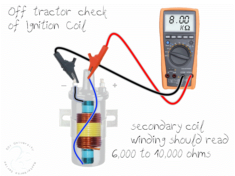

953 nut 69,256 #47 Posted August 15, 2025 Remove the wires from you ignition coil and test the primary winding and secondary windings. Share this post Link to post Share on other sites
Krice58 181 #48 Posted August 16, 2025 (edited) 1 hour ago, 953 nut said: Remove the wires from you ignition coil and test the primary winding and secondary windings. Primary 3.4 ohms Secondary 9300 ohms Checked the condenser too, from what I researched it said to ground it on itself check for continuity to “charge” and then voltage to “discharge”. The videos I saw showed the ohms rising as it was charging and then volts falling as it was discharged. When I replicated this, I had no rise in ohms when charging and very low volts when discharging. Could this be part of the problem? It’s a newer condenser. I wouldn’t think it failed already, but I guess it’s possible. That would cause no spark wouldn’t it? Edited August 16, 2025 by Krice58 1 Share this post Link to post Share on other sites
