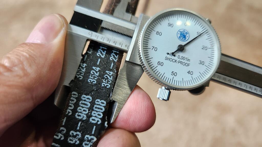

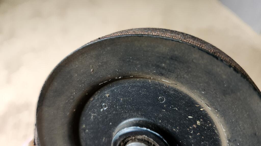

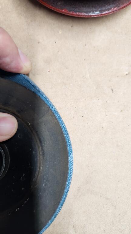

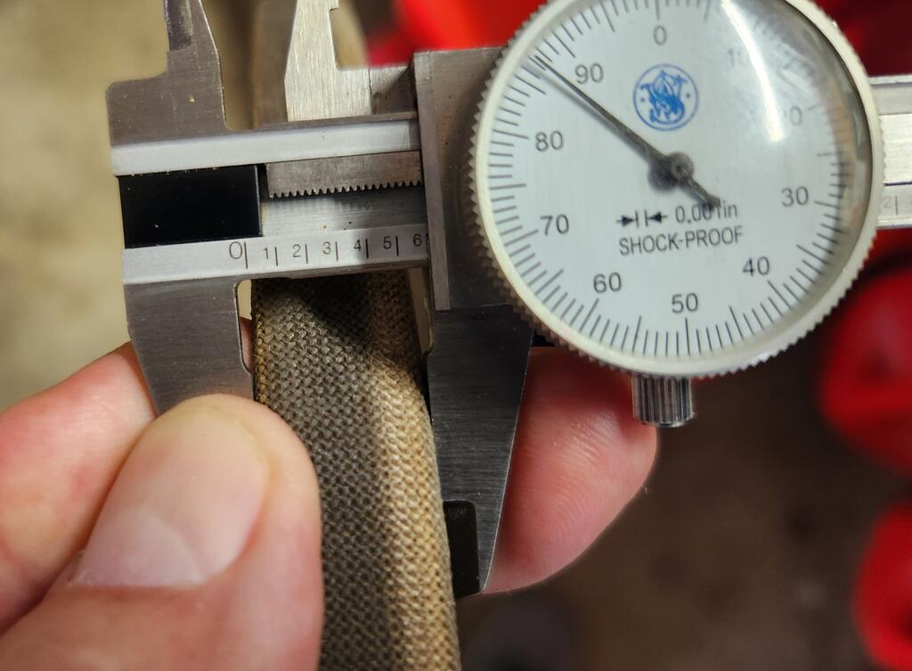

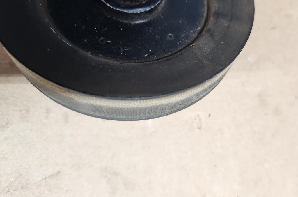

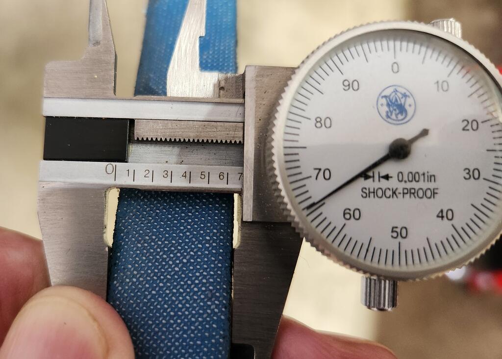

Racinbob 12,812 #1 Posted July 30, 2025 I had to replace the idler on the 2005 and I noticed the belt was looking not so good. I know a lot of you like the Tractor Supply Kevlar belts and I do too. I use them on about everything. I had a 5L820 (from Ebay) in my stash for quite a while. I had tied to use it on the Dino project and it was far too tight. I picked up a TSC 5L830 and it seemed like it would be fine but I couldn't test drive it. I pulled the belt I had back out to use on the 2005. Same thing. Too tight. This time I measured it. It was 81" No wonder I couldn't even get it on. Now that I knew the Ebay belt was simply undersized I picked up a TSC Huskee 5L820. It was tighter than I liked. It worked and I mowed with it a day hoping it would 'seat' in. Not really. I did not like the way it felt. I ordered two OEM Toro belts. Look at these numbers. Used OEM being replaced. .587+ How it rides on the idler. Huskee 5L820 .666 On the idler. New Toro OEM .611 On the idler. I have a Huskee on the 854 drive and it's fine but, of course it a 4L . I know a lot of you guys use the blue belts on the drive with no issues but it just didn't happen for me. For decades I said the TSC belts are great but suggested to use OEM on the drive. I've heard it mentioned that Toro specs are a bit different. Never really believed it. I have to question it now. I'll use them on my 4L machines but pay the OEM price for the ones that use a 5L. By the way, the 5L820 that measured 81" was a D&D from Ebay. 2 Share this post Link to post Share on other sites

Racinbob 12,812 #14 Posted August 1, 2025 Again, I'm only talking about the 5/8" drive belts. The older machines used 1/2" drive belts and I've never had a problem there. The two new 93-9808 OEM belts I just got fit fine and clutch properly where the D&D and Huskee belts didn't. The physical difference in size is very obvious. 1 Share this post Link to post Share on other sites
953 nut 64,340 #15 Posted August 2, 2025 A few months back a member had a belt problem with a 5/8" D & D belt that actually measured nearly 3/4", guess they aren't checking their quality. I haven't had to replace a belt lately but had always had good luck with the TS Kevlar belts in the past. Guess I will have to take along a digital caliper next time I go belt shopping. 1 Share this post Link to post Share on other sites
