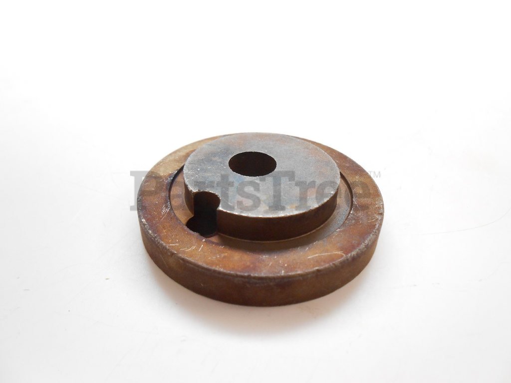

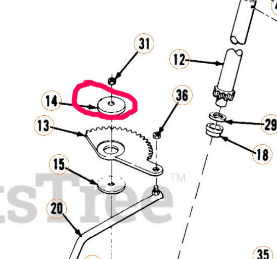

OldNoob 27 #1 Posted July 30 Hi All I realize the 210-5 is not a true Wheel Horse but i wonder if maybe someone can help me. My mower comes with this cammed bushing that the steering plate gear centers on. Does anyone know if the bushing can be truned to tighten the clearance between the shaft gear and the plate gear? Share this post Link to post Share on other sites

Ed Kennell 43,327 #4 Posted July 30 to the I have zero experience with a 210, but the eccentric bushing is designed to adjust the clearance of the steering gears. Like Bill stated above, this may be a short term fix if the gear teeth are worn. 2 Share this post Link to post Share on other sites
WHX?? 53,079 #5 Posted July 30 You should be able to loosen the thru bolt and turn the cam for closer sector gear to pinion. Not too tight to avoid binding and further tooth wear. a lube of some sorts would help ease turning. 5 Share this post Link to post Share on other sites
