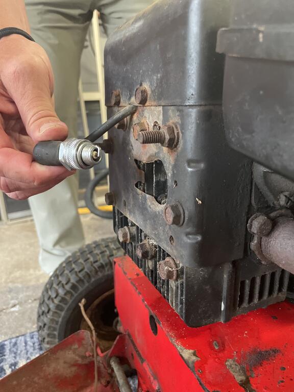

Mattthetrac 12 #1 Posted yesterday at 12:36 AM I’m back. I have replaced the sparkplug and there is still no spark no matter what I do. Any recommendations or ideas? Share this post Link to post Share on other sites

Gasaholic 294 #6 Posted 23 hours ago 17 hours ago, Mattthetrac said: I’m back. I have replaced the sparkplug and there is still no spark no matter what I do. Any recommendations or ideas? If you are checking for spark at the spark plug like that, you need to have the plug body grounded to bare ground , not any of that painted engine surface , and just holding it in your hand where it is at currently, of course you'd see no spark..... Share this post Link to post Share on other sites
