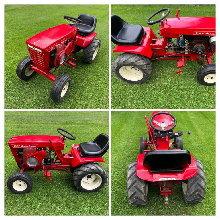

ML3 2,195 #1 Posted July 27, 2025 (edited) Found a 1057 local right in town for sale. Was asking $400, now its down to $350. Got me thinking........ Price seems reasonable?? Definitely notice belt guard missing. Also saw what looks like mounting bracket for possible center grader blade?? Don't really have anymore room for another tractor & don't really need a "working" tractor. More to just satisfy my hoarding needs! 🤣🤣 Question is to buy or not......🤔 Edited July 27, 2025 by ML3 4 3 Share this post Link to post Share on other sites
ebinmaine 77,976 #3 Posted July 27, 2025 The belt guard may be reproduced from another model. The piece underneath is likely for a 60s mower deck. The paint looks excellent. I'd absolutely buy it for no particular reason. Share this post Link to post Share on other sites

Handy Don 16,112 #10 Posted July 28, 2025 There was definitely something underneath, but what? It kinda looks like part of the frame for a geared mower deck. Share this post Link to post Share on other sites
ML3 2,195 #11 Posted July 28, 2025 Looked at 1057 tonight. No belt guard been on for a while so it grinds into gear - water in trans gear lube - needs throttle/governor adjustment?? - brake band seal leaking so brake lining is saturated w/fluid - painted with roller - right axle appears a bit loose - rear tires pretty much shot I know its only $350 but seems like a lot is needed. He said he'd take $325. Im thinking $200 at the absolute most. 3 Share this post Link to post Share on other sites
